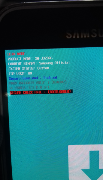

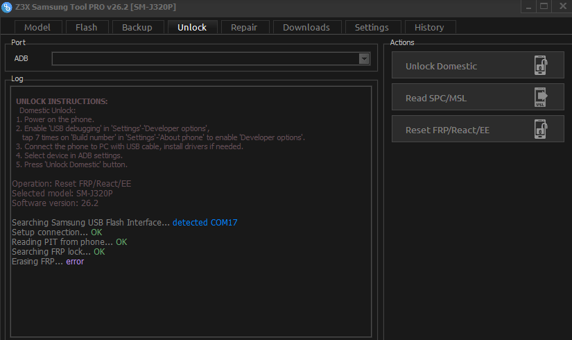

Hang on Logo lang at tsaka na ON FRP, custom binary blocked by frp kung e flash kahit anong firmware at pasikotsikot sa flashing ayaw mag tuloy. Kahit ilang combi files ayaw tanggapin.
Action Taken:

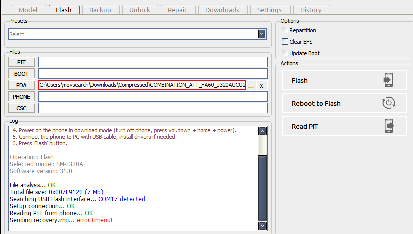

Flash with custom firmware no luck
Flash with original firmware no luck
Flash with combi files no luck
Flash firmware at combi with low and high z3x software version no luck
Erase FRP no luck

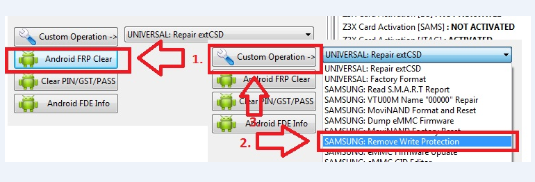

Ang Solution:

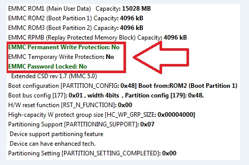

Gamitin ang z3x jtag box at sundan ang screenshots
Naka YES ang isa dyan, di ko lang matandaan saan isaktong naka YES, hehehe sorry, di ko inakala magawa pa.

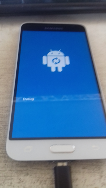

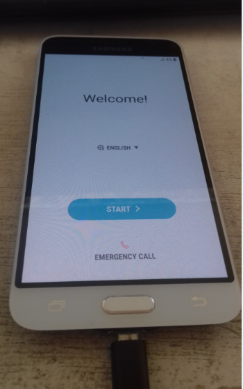

After ko magawa yan, tanggal ko na jtag pins sa board then program ko gamit Z3X Pro, yun nagtuloy na flashing without error na sya, wala na yong "CUSTOM BINARY BLOCKED BY FRP"

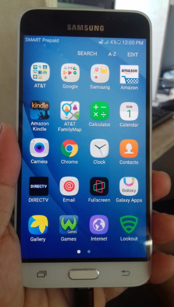

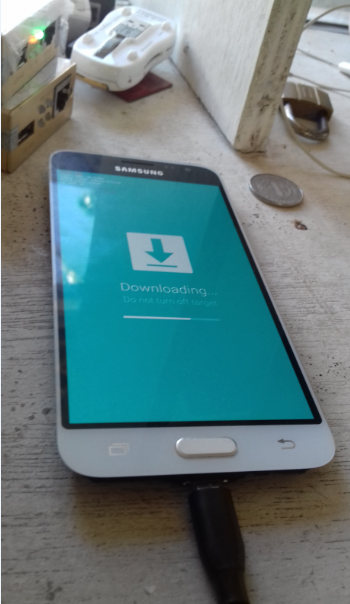

Finish Product:
Action Taken:
Erase FRP no luck

Ang Solution:
Finish Product:
