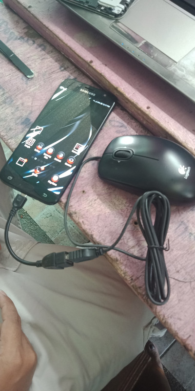

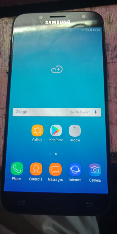

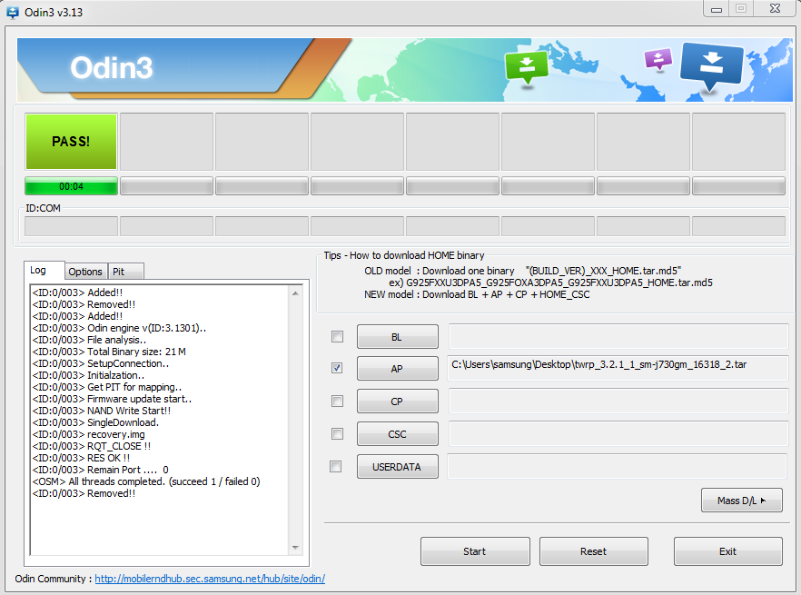

J730G TOUCH ISUE 8.0 DONE SA DOWN GRADE 7.0...
VIDEO TOUCH ISUE__https://www.facebook.com/macud.jalil123/videos/pcb.2184933871830945/2184931365164529/?type=3&theater
FIRST USE OTG MOUSE PUNTA KA SA BUILD NUMBER 5X.. DEVELOVER. ON OEM AT USB DEBUGGING..

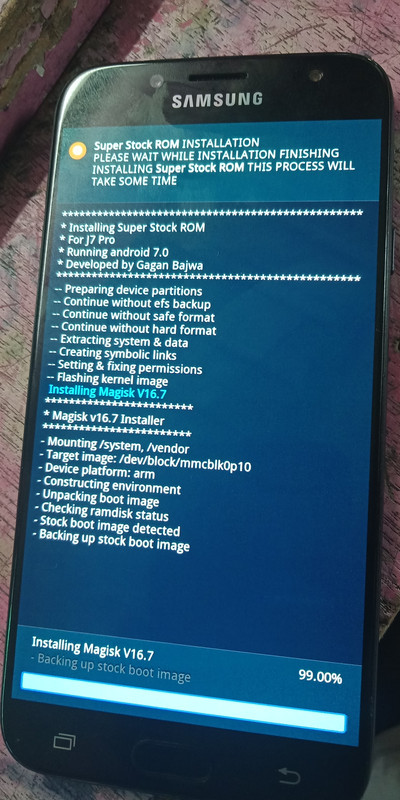

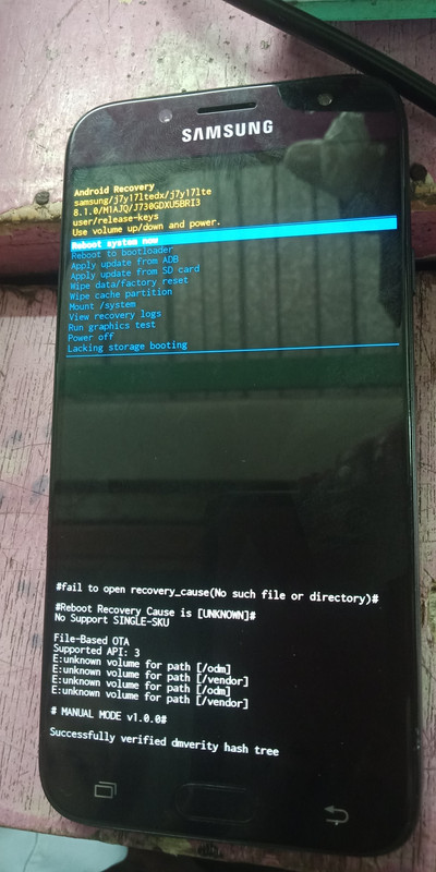

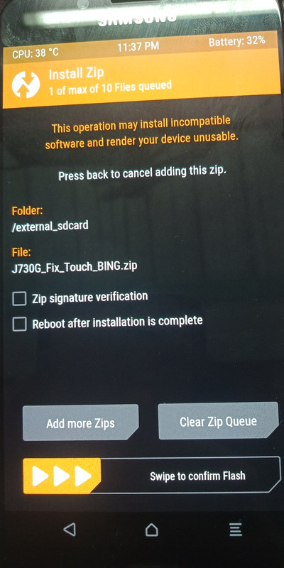

TOOLS TWRP TESTED J730G.https://www.4shared.com/rar/sO9PDEXqee/twrp_321_1_SM-J730G_TESTED_MAC.html
PAG NA IFLASH MUNA YAN...

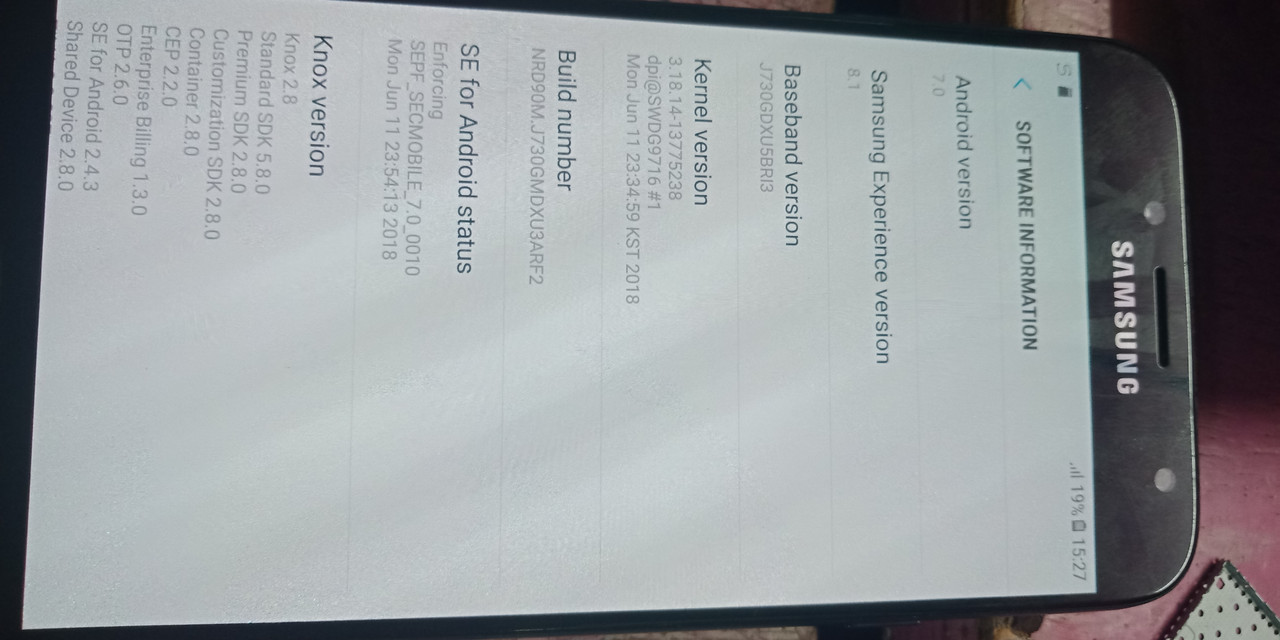

DOWNLOAD MO ITO DOWN GRADE J730G_7.0 TESTED PO...https://drive.google.com/uc?id=18sAx8TX5A8keWLFt0uWcOYkf4AS1zMVD&export=download

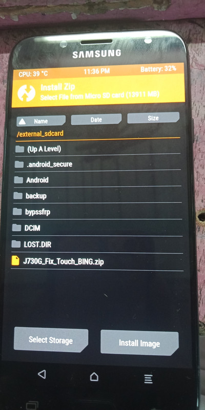

PAG KATAPOS ILAGAY NYO SA SDCARD YOUNG ZIP.
