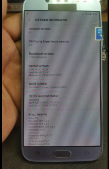

J7 PRO nagpareplace ng lcd ayaw na matouch binary6 version9

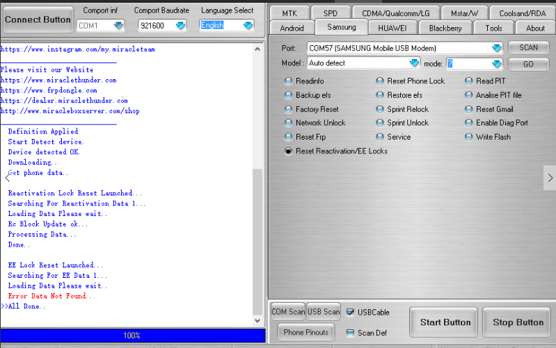

use otg at mouse pra mapasok si oem pero sa lagay ko ay nakahide si oem
kya open miracle crack v2.52 download mode phone
press reset reactivation/ee locks after that error na ang phone
dont worry just open z3x and press read pit magrereboot po yan back to normal
ngaun punta napo ulit sa settings 101% my oem unlock na yan edownload mode lng po ulit tingnan kung naka off na oem at cmpre ang frp

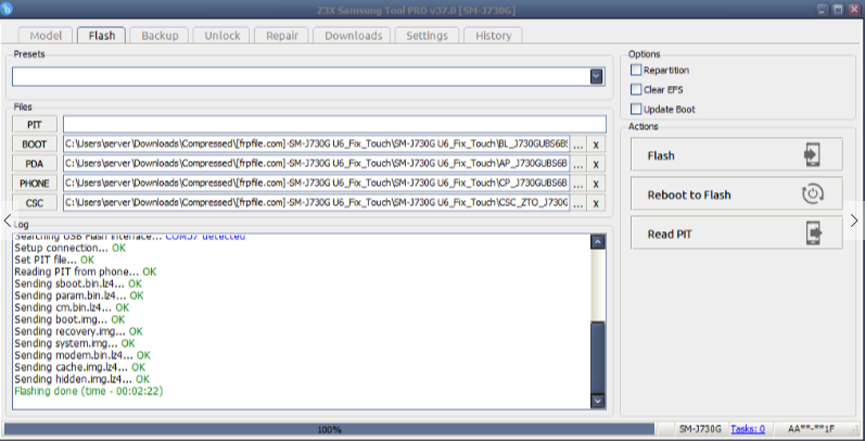

ito napo ang final download mo ito SM-J730G BIN6 TOUCH FIRMWARE
open z3x then flash BL,AP,CP,CSC after flash automatic reboot to twrp,sa twrp press wipe at format data enter yes/tapos back at do not install

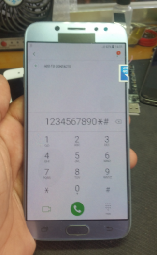

tapos magrereboot na
DONE.
