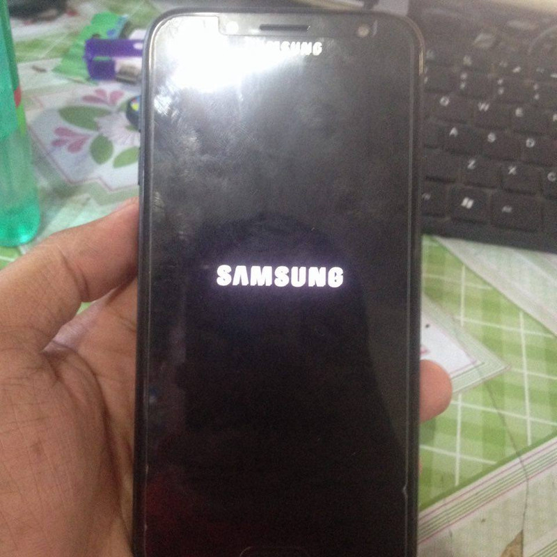

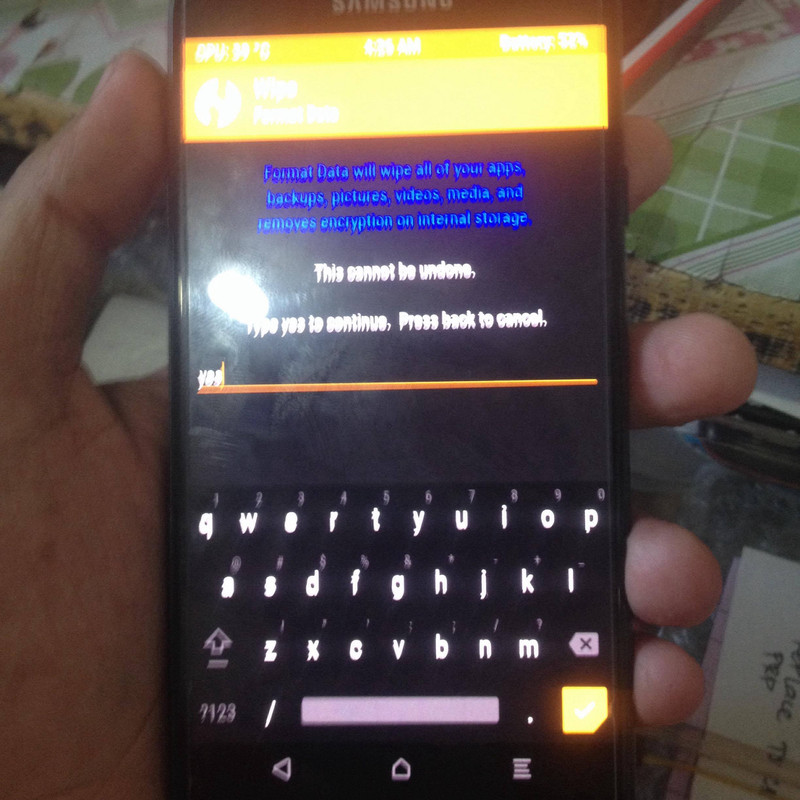

SM-J730G/DS NO TOUCH AFTER UPDATE DONE
SHARE KO LANG MGA BOSSING
samsung j7 pro
ayaw na matouch after update done na po

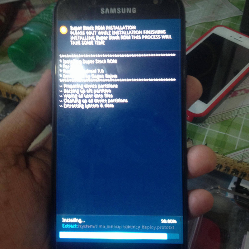

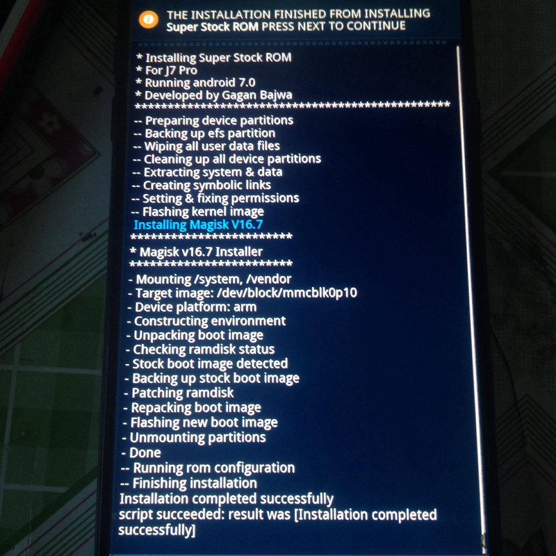

salamat sa thread ni boss fullflash
lawakan lang ang pag iisip
http://www.antgsm.com/showthread.php?t=193297

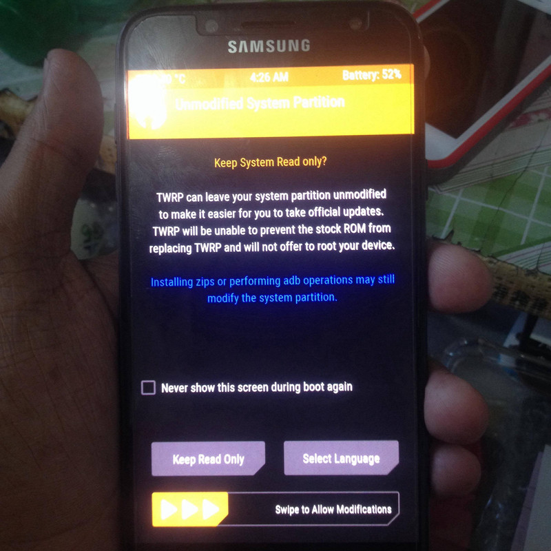

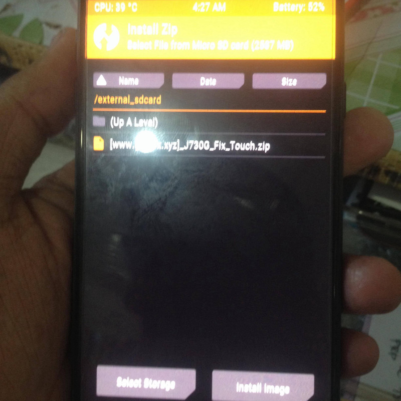

tools
otg
mouse
sd card
presense of mind
at sa video na to na sinundan ko
https://www.youtube.com/watch?v=xT1hi-0AMeQ
sundan nio nalang din po procedure kung tunay na tech easy lang yan
firmware here
https://drive.google.com/uc?id=18sAx8TX5A8keWLFt0uWcOYkf4AS1zMVD&export=download
twrp
https://drive.google.com/file/d/1sTmeS37D4ebDk_bIBjawKmXJr52L7kq2/view
screenshots
<a href='https://postimages.org/' target='_blank'><img src='https://i.postimg.cc/wB3J8j2v/Capture.png' border='0' alt='Capture'/></a>

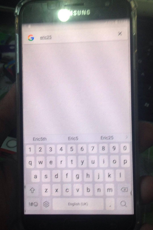

finish product
