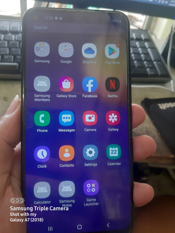

ito po ang phone ;

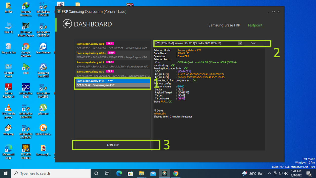

ito nman po ang procedure;
1.remove back cover
2.disconnect battery
3.open frp samsung qualcom tool
4.select samsung erase frp
5.choose samsung galaxy m11 frp
sm-m115f snapdragon 450
6.test point then insert usb type c cable
7.scan
8.erase frp

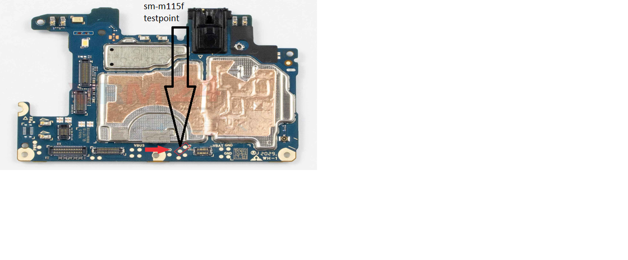

ito nman po picture ng test point

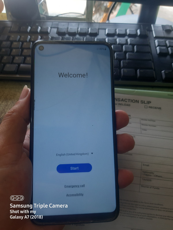

DONE:
