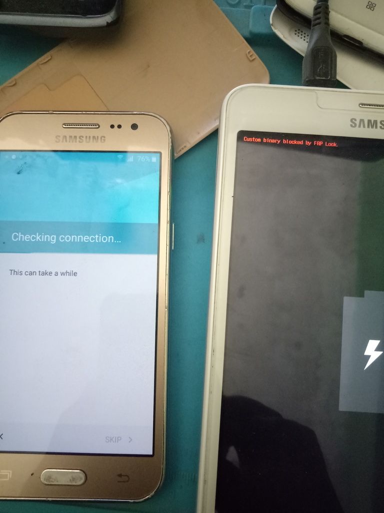

SM-T285 CUSTOM BINARY BLOCKED BY FRP AND UNKNOWN BASEBAND

1ST STEP PLASH WITH..http://www.mediafire.com/file/0892knhali8p6a5/COMBINATION_OXA_FA51_T285XXU0APC2_OXAFAC.zip/file FOR ENABLE ADB DEBUGGING AND ON OEM

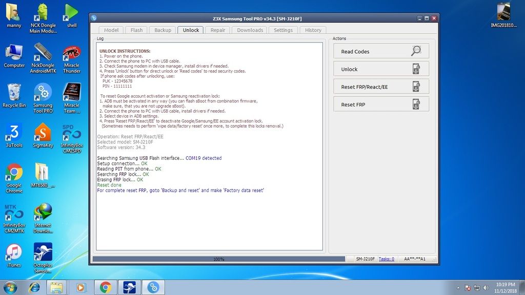

2ND OPEN Z3X PRO.. AND SELECT SM-J210F.. GO TO TAB UNLOCK.. INSERT USB PORT HIT Reset FRP/React/EE
3rd flash again with this file http://www.mediafire.com/file/sdwzrbmcwdshris/T285_XXU0APJ2_OLB0APJ3.zip/file

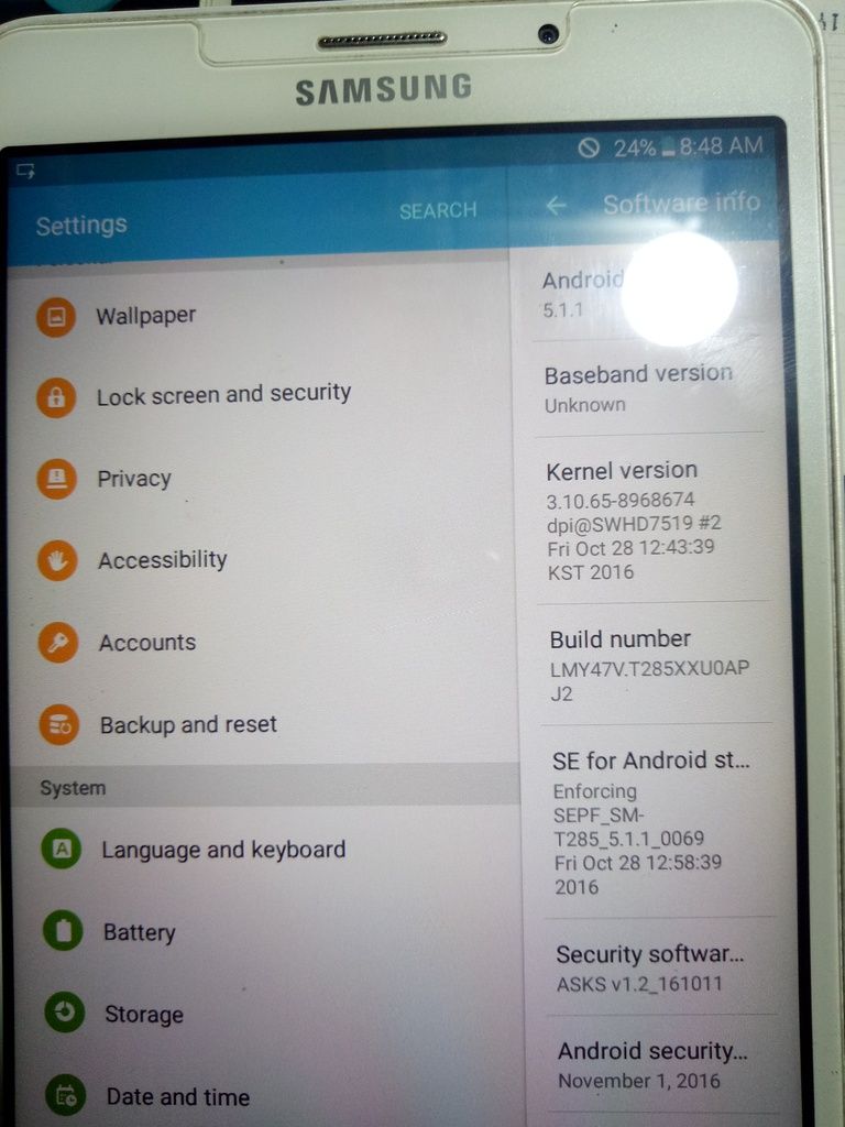

ok buhay na.. unknown baseband naman

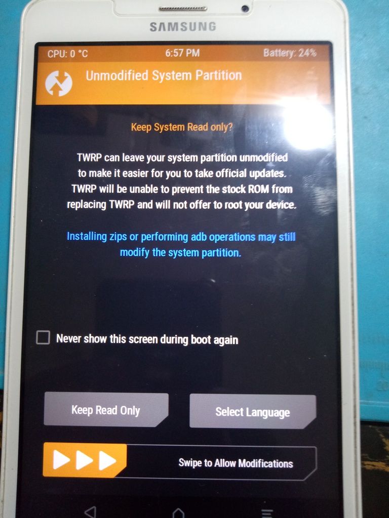

4th step.. use odin and flash this http://www.mediafire.com/file/8750w...by_DR.G_MOBILE__TWRP_3.0.2-1_SM-T285.zip/file

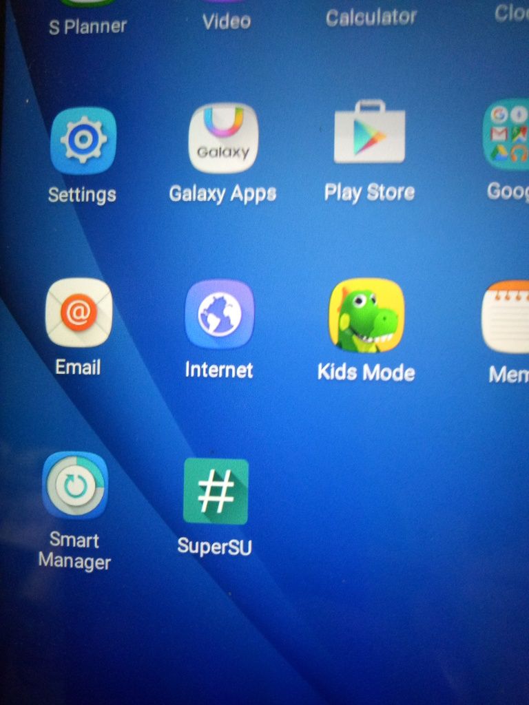

ito pang root copy nyo sa memory card and flash via recovery mode..http://www.mediafire.com/file/5wazrel51j185ja/BETA-SuperSU-v2.77-20160827190633.zip/file
ok rooted na sya open mo naman si pusit. and rebuiled imie
DONE...
