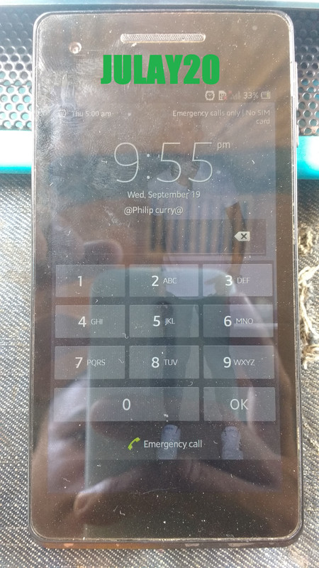

nakalimotan ng tumer ang password dinala sa kabilang tech dinala din ng tech pabalik sakin :D di alam pano hard reset eh kaya binalik din sa akin =))

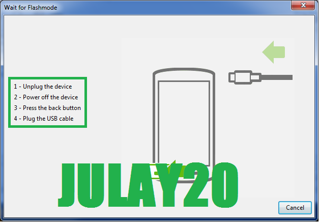

Procedure:

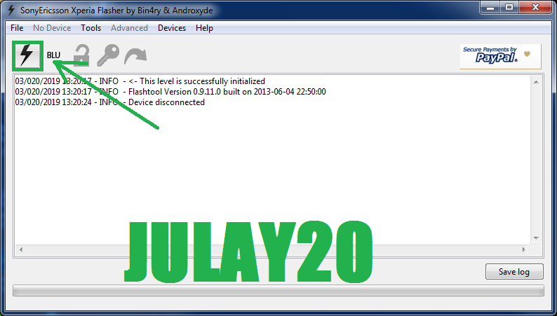

open flash tool kong wala download HERE!
Click mo yung kidlat malapit sa BLU
Lalabas yung bootmode chooser

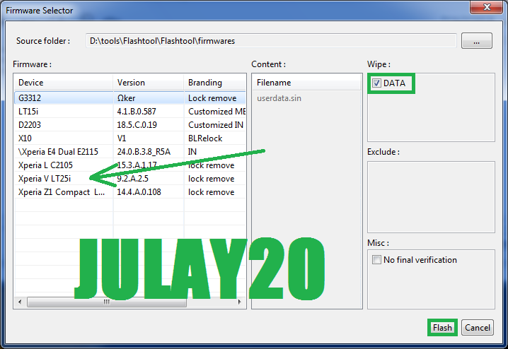

Celect Flashmode click ok
Lalabas Firmware selector
Piliin mo yung file na na download mo yung LT25i
Click wipe data
Click flash

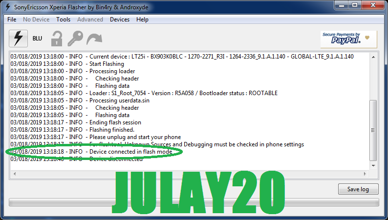

lalabas naman yung wait for flashmode

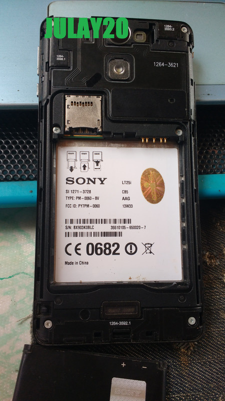

sondaan mo yung 1 to 4 na naka solat
hold voll down saksak usb mag flash na yan hayaan mo lang
pag lomabas na yung Device connected in flash mode

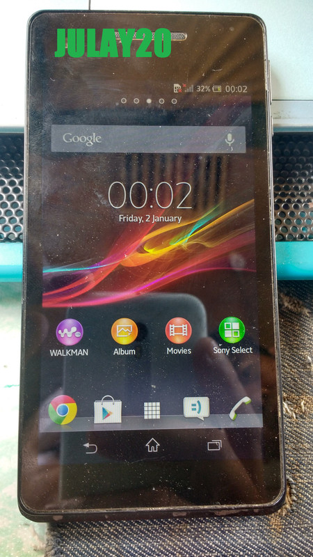

tangalin mo na ang USB tangal battery kabit uli battery power on mo na wait hangang mag home screen done pera na :D
