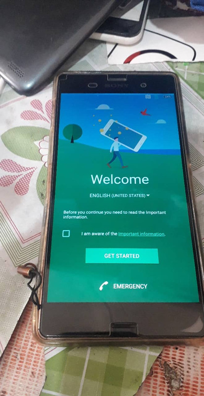

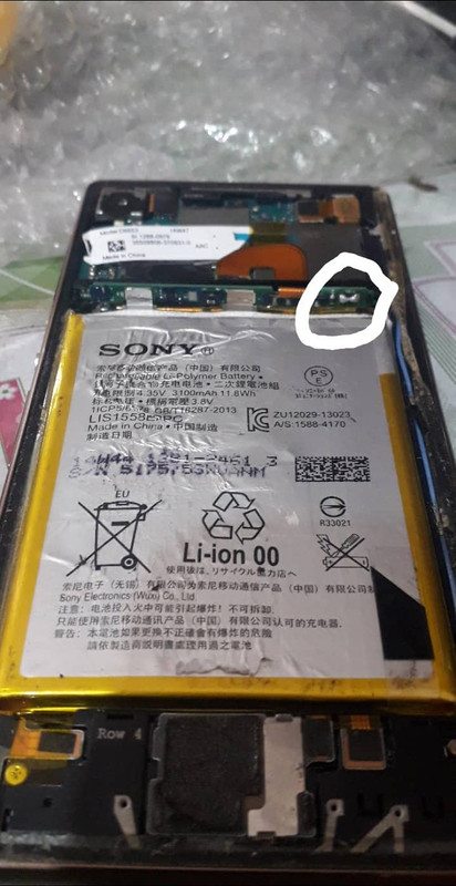

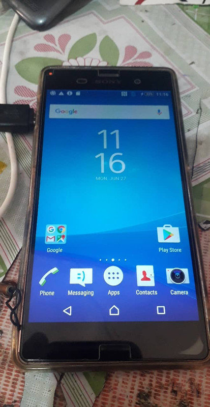

Sony Xperia D6653 Restarting Logo Done
history. bigla nalang daw nag restarting sa logo pagbuhay palang
action taken. flash user data using sony flashtool complete pero no luck
last option download ako firmware
while waiting sa download basa basa muna
ayun may nakita ko
posible na batery problema pero wala ako batery
kya try ko yung tricks na to
baklas batery
remove fuse L7
then jumper
finish na
cancel ko na download ng firmware 1.8gb eh
ok na unit
bagong format naformat ko n eh
