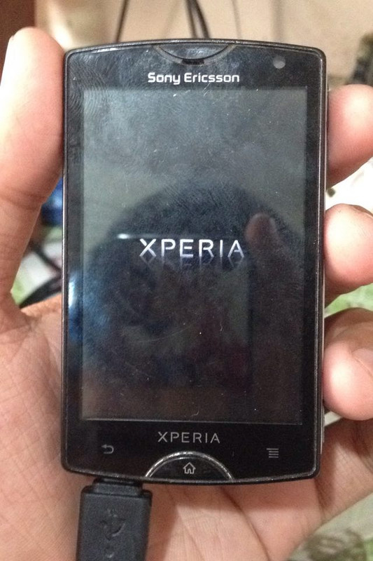

problem hang in logo

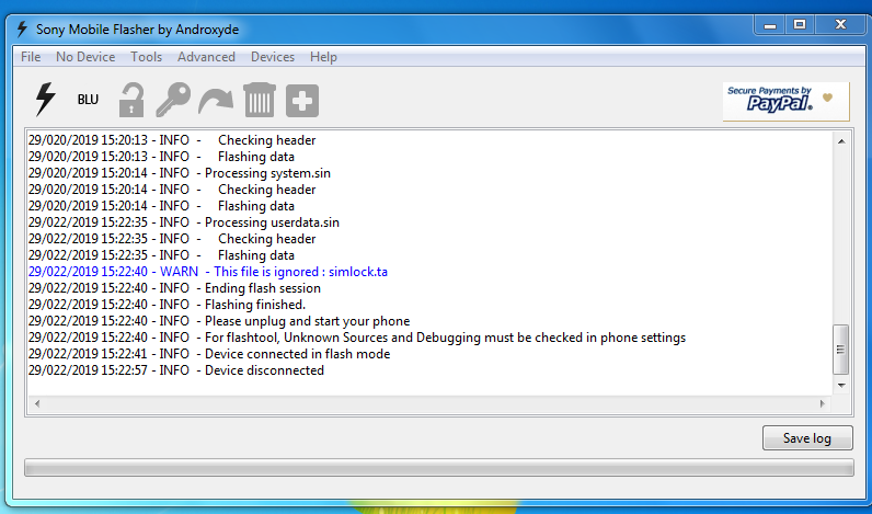

procedure
open flashtool run as admin
click yung kidlat
then flashmode
put firmware in local disc c/flashtool/firmware
load firmware
then flash
hold volume down
insert usb
wait untill finish

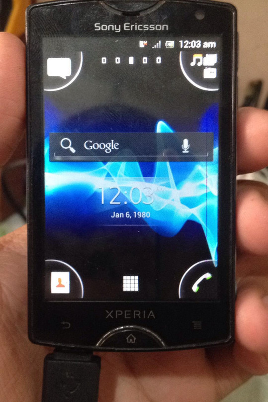

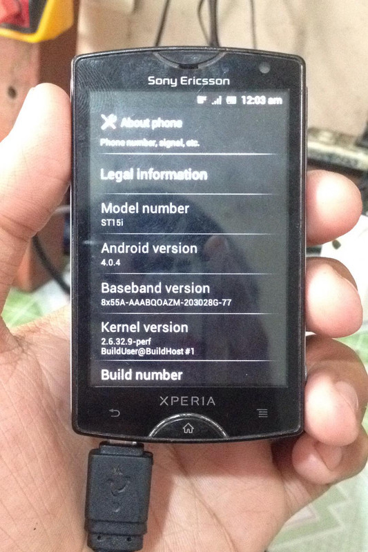

done
