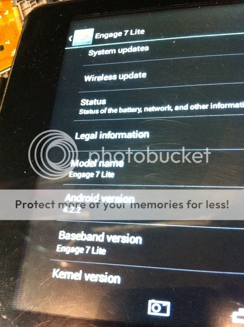

share ko lng po sa inyo gawa ko tablet Engage 7 lite, hang po sa logo. ref lng po ito sa mga baguhan tulad ko....
Ona download muna to..
Firmware...https://mega.co.nz/#!qRBUXRLA!4tO4iby1LkMx2SmBkh8sxE3ISONpU_c2OJiZ9t7wy1s
Driver..http://www.cnx-software.com/2013/11/08/simplified-method-to-install-rockchip-usb-drivers-
in-windows-xp78/
Procedure...
1.hold niyo lang po ang Volume up saksak niyo usb install driver ang hit RUN...
2.Wait niyo lng hang matapos...
Pictures tablet sa likod...
Ito po problima hang logo..
Picture for Flashing..
Finish Product...
HIt THANKS lang Po masaya na ako.......

gud pm po sa inyo mga idol....
in-windows-xp78/
Procedure...
Finish Product...
