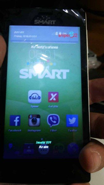

Unit:
Starmobile Play click (Silver)
Phone info:
Model Name : c120_ttc_031
Model Brand : Starmobile
Model Device: c120_ttc_031
AndrVersion : 5.1
BaseBand CPU: C120_TTC_031
Project Ver : LMY47D release-keys
Model Ext : Starmobile PLAY Click
Problem:
Invalid sim

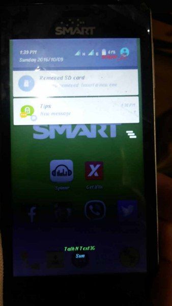

Action taken:
> Cm2SPD v1.22
> CPU platform sc7730..Sc7731 android 6.x
> Unlock
> Bootkey(Voldown)
Operation : SP Unlock [ v1.22 ]
Mode : DirectUnlock
1. Remove battery. Insert battery back
2. Press and hold 'VolumeUp' and 'VolumeDown' keys
3. Insert cable
==== Wait for phone...
Phone found! [ 11 ]
Port Opened
Sync...
InitBoot Done [ 0x81 ] , Ver : SPRD3
Sync...
Sending FDL
[Info] : If SW freeze here more, than 15 seconds - remove cable
FDL Ready!
Boot Ver : SC7731 Crev eMMC Loader v2.0
Sending FLASH FDL
FLASH FDL Ready!
Boot Ok!
Detected eMMC Flash , Structure detect Ok!
Checking Structure ...
SimLock state : Locked!
Unlocking ...
Unlock Done!
Elapsed: 00:00:33
Reconnect Power/Cable!
UNLOCKED. Done
