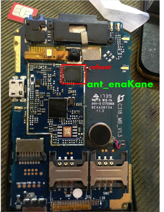

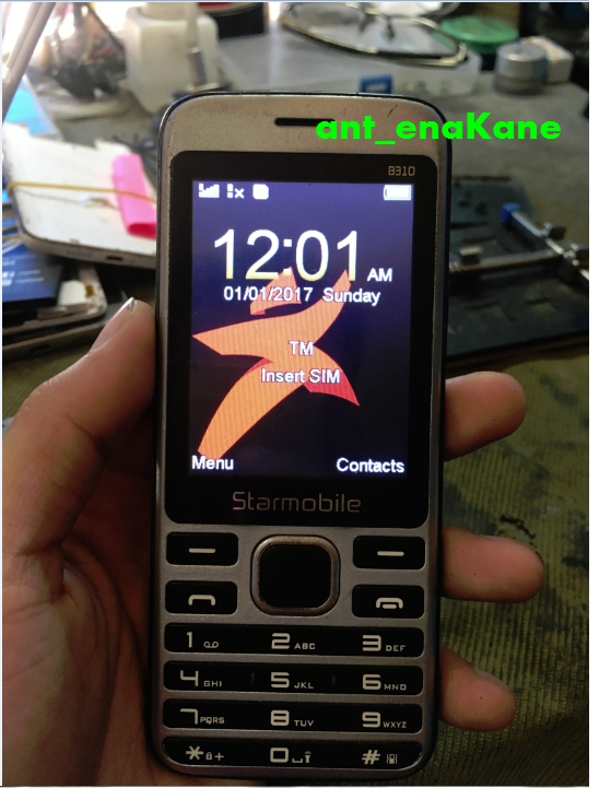

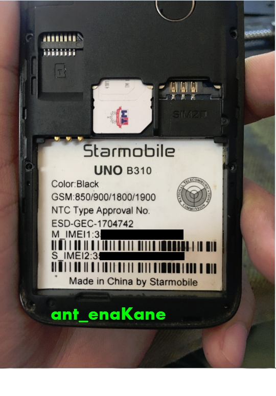

UNIT: STARMOBILE UNO B310
ISSUE: NO SIGNAL
kahet anong sim na cnubukan ganun padin, finormat na ganun pa din
basa labas kaya naisip ko na baka napawisan loob
(sorry no pic) nd ko inasahan magagawa ko hehehe
SOLUTION:
OPERATION BAKLAS UNIT
THEN REHEAT KO LANG UNG NSA PIC
(may kumukulo, basa nga)
TRY KO ON UNIT, NO SIGNAL PA DIN
NEXT STEP, FORMAT
SETTINGS LANG MGA BOSS
TPOS DEFAULT CODE FORMAT NG STARMOBILE
1122
(anjan lang ung code sa taas hanapin mo hehehe)
DONE MGA BOSS
