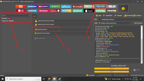

BAGGER Expired Account Joined Oct 18, 2021 Messages 620 Reaction score 561 Points 421 Location Cebu Dec 11, 2022 #1 hardreset muna vol up and power procedure: 1. open unlocktool 2. go to techno tab 3. select model F4 4. select ERASE FRP 5. volume down and up done
