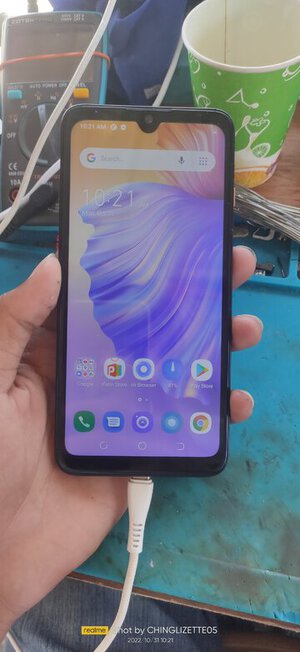

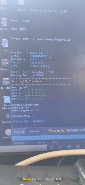

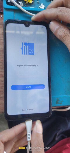

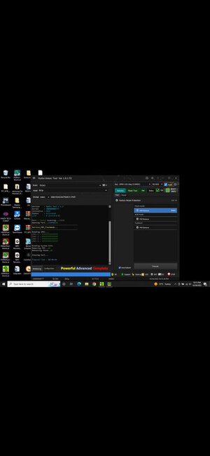

TECHON POP 5 A.K.A BD2p 32+2 E FRP REMOVE BY HYDRATOOL SPD
Step by step ...
1. Open HUMTOOL and select HSPDTOOL
2. SELECT MODEL TECNO BD2p
3. Boot info first volume down bootkey
Pag deteck na SELECT FRP FLASHMOOD AND WAIT DONE ✅✅
SEE THE PICTURES BELOW ...
