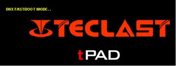

Step 3. start tablet and enter Android os, shutdown. Then long-press “power, vol up, vol down” 3 buttons at the same time, until “DNX FASTBOOT MODE…” words appear, as below:
Step 4. connect tablet with computer, after computer recognize the device driver, flash tool will appear “Start to Flash” button, it means that tablet connects computer successfully.
