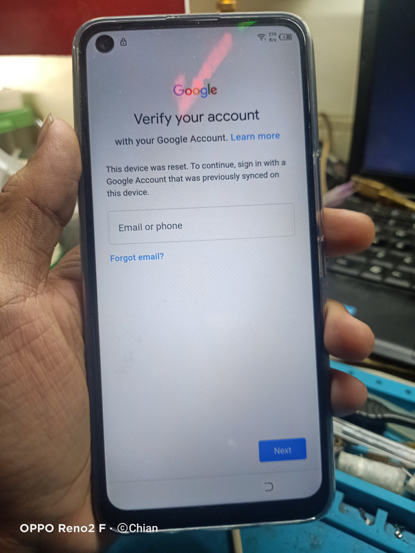

Good day everyone. Today may tanggap ako Tecno KF8 FRP issue
Proceed tayo sa process.

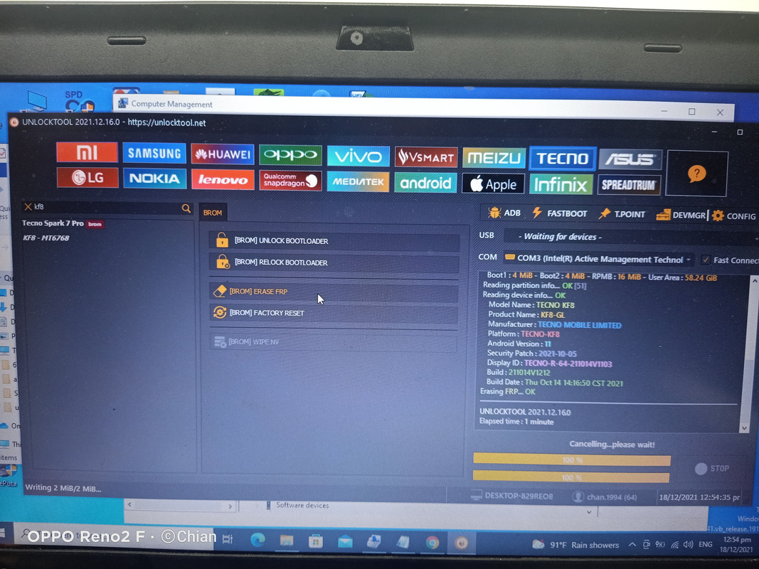

Open unlock tool and click po ang (TECNO) then click [BROM] ERASE FRP then hold volume up and volume down at isaksak ang usb

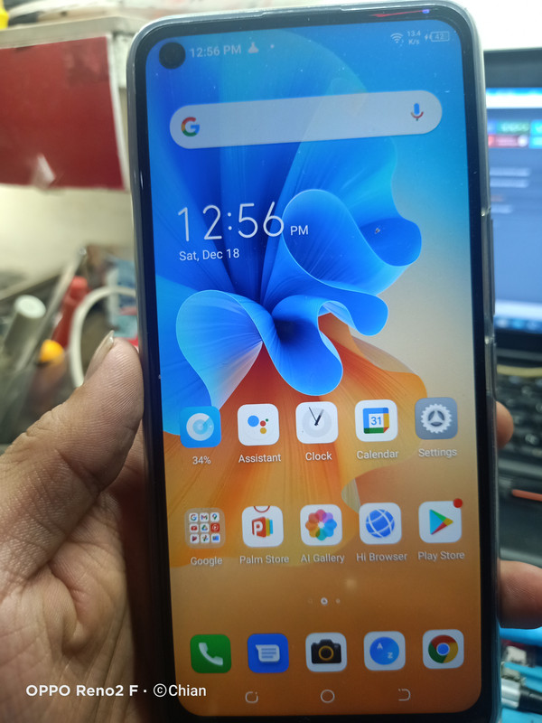

Heto naman po ang proof ko

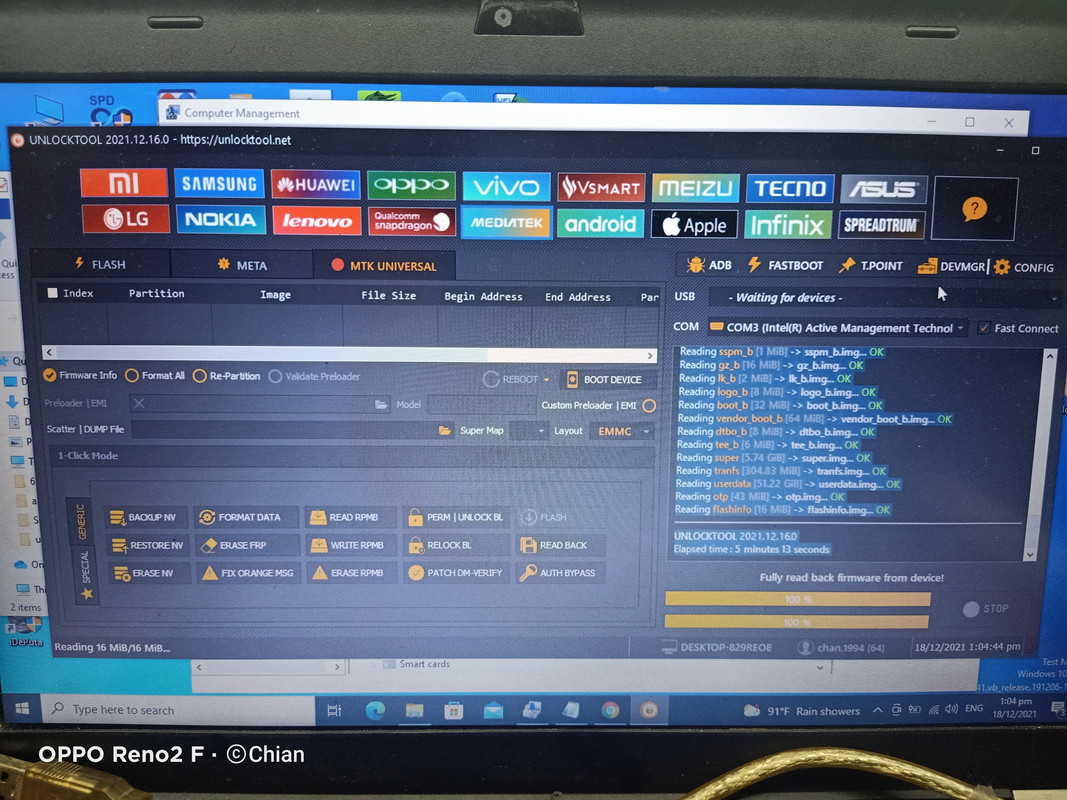

Para sa back up naman
READ BACK Authenticating... OK
Initializing usb... OK
Waiting for device... COM103
Bypassing authentication... OK
Analyzing preloader... preloader_kf8_h696.bin [EMI:15] [Internal]
Handshaking... OK
Reading hardware info... OK
Hardware : MT6768 [Helio G70|G80|G85|P65] [0x707] 8A00 CA00 0000
Security Config : SCB SLA DAA
MEID : D3CD262083692C7C4BD49132B83A2CB6
Sending Download-Agent... OK
Syncing with target... OK
Booting device... OK
Syncing with DA...
Storage : EMMC - CID : 33000115.4D433650.C8EF0242.1718C7D4
Vendor : Samsung - Name : 3P6CMB - Serial : 3352611055 - Rev : 2
Boot1 : 4 MiB - Boot2 : 4 MiB - RPMB : 16 MiB - User Area : 58.24 GiB
Reading partition info... OK [51]
Reading device info... OK

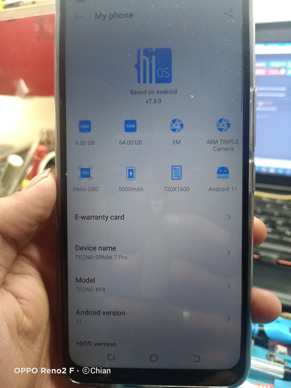

Model Name : TECNO KF8
Product Name : KF8-GL
Manufacturer : TECNO MOBILE LIMITED
Platform : TECNO-KF8
Android Version : 11
Security Patch : 2021-10-05
Display ID : TECNO-R-64-211014V1103
Build : 211014V1212
Build Date : Thu Oct 14 14:16:50 CST 2021
Reading preloader [512 KiB] -> preloader.bin... OK
Reading pgpt [32 KiB] -> pgpt.bin... OK
Reading boot_para [26 MiB] -> boot_para.bin... OK
Reading proinfo [3 MiB] -> proinfo.bin... OK
Reading misc [512 KiB] -> misc.img... OK
Reading para [512 KiB] -> para.bin... OK
Reading expdb [20 MiB] -> expdb.bin... OK
Reading frp [1 MiB] -> frp.bin... OK
Reading tkv_a [1 MiB] -> tkv_a.img... OK
Reading vbmeta_a [8 MiB] -> vbmeta_a.img... OK
Reading vbmeta_system_a [8 MiB] -> vbmeta_system_a.img... OK
Reading vbmeta_vendor_a [8 MiB] -> vbmeta_vendor_a.img... OK
Reading tkv_b [1 MiB] -> tkv_b.img... OK
Reading vbmeta_b [8 MiB] -> vbmeta_b.img... OK
Reading vbmeta_system_b [8 MiB] -> vbmeta_system_b.img... OK
Reading vbmeta_vendor_b [8 MiB] -> vbmeta_vendor_b.img... OK
Reading md_udc [22.6 MiB] -> md_udc.bin... OK
Reading metadata [32 MiB] -> metadata.img... OK
Reading nvcfg [32 MiB] -> nvcfg.img... OK
Reading nvdata [64 MiB] -> nvdata.img... OK
Reading persist [48 MiB] -> persist.img... OK
Reading protect1 [8 MiB] -> protect1.img... OK
Reading protect2 [12.37 MiB] -> protect2.img... OK
Reading seccfg [8 MiB] -> seccfg.bin... OK
Reading md1img_a [128 MiB] -> md1img_a.img... OK
Reading spmfw_a [1 MiB] -> spmfw_a.img... OK
Reading scp_a [6 MiB] -> scp_a.img... OK
Reading sspm_a [1 MiB] -> sspm_a.img... OK
Reading gz_a [16 MiB] -> gz_a.img... OK
Reading lk_a [2 MiB] -> lk_a.img... OK
Reading logo_a [8 MiB] -> logo_a.img... OK
Reading boot_a [32 MiB] -> boot_a.img... OK
Reading vendor_boot_a [64 MiB] -> vendor_boot_a.img... OK
Reading dtbo_a [8 MiB] -> dtbo_a.img... OK
Reading tee_a [6 MiB] -> tee_a.img... OK
Reading sec1 [2 MiB] -> sec1.bin... OK
Reading nvram [70 MiB] -> nvram.img... OK
Reading md1img_b [128 MiB] -> md1img_b.img... OK
Reading spmfw_b [1 MiB] -> spmfw_b.img... OK
Reading scp_b [6 MiB] -> scp_b.img... OK
Reading sspm_b [1 MiB] -> sspm_b.img... OK
Reading gz_b [16 MiB] -> gz_b.img... OK
Reading lk_b [2 MiB] -> lk_b.img... OK
Reading logo_b [8 MiB] -> logo_b.img... OK
Reading boot_b [32 MiB] -> boot_b.img... OK
Reading vendor_boot_b [64 MiB] -> vendor_boot_b.img... OK
Reading dtbo_b [8 MiB] -> dtbo_b.img... OK
Reading tee_b [6 MiB] -> tee_b.img... OK
Reading super [5.74 GiB] -> super.img... OK
Reading tranfs [304.83 MiB] -> tranfs.img... OK
Reading userdata [51.22 GiB] -> userdata.img... OK
Reading otp [43 MiB] -> otp.img... OK
Reading flashinfo [16 MiB] -> flashinfo.img... OK
UNLOCKTOOL 2021.12.16.0
Elapsed time : 5 minutes 13 seconds
