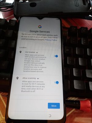

Share ko lang mga boss itong tecno pova neo nakalimutan ang password kaya try ko hard reset at success naman kaso nanghingi nang google account kaya Dito ko tinira

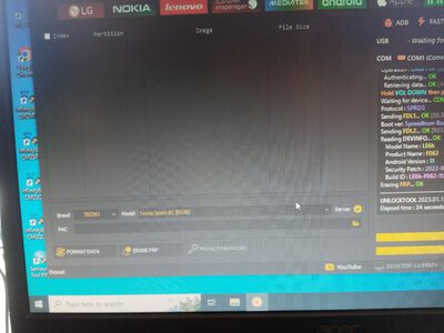

1. Open unlocktool
2. Select Tab SPD
3. Select Model (Tecno/ Tecno Spark 8c [KG5K]
4. Click Erase FRP
5. Hold Vol+ and Vol- Din insert Usb Cable
hintayin lang hanggang matapos ^_^

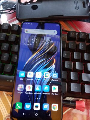

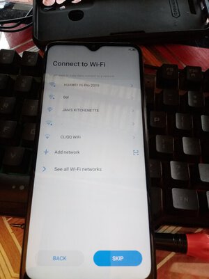

At ito po patunay

At ito po patunay
Tested po.....Salamat
