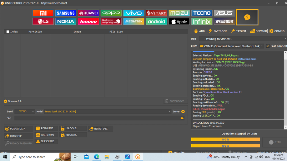

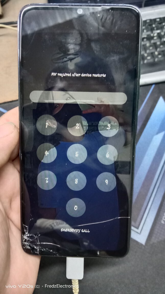

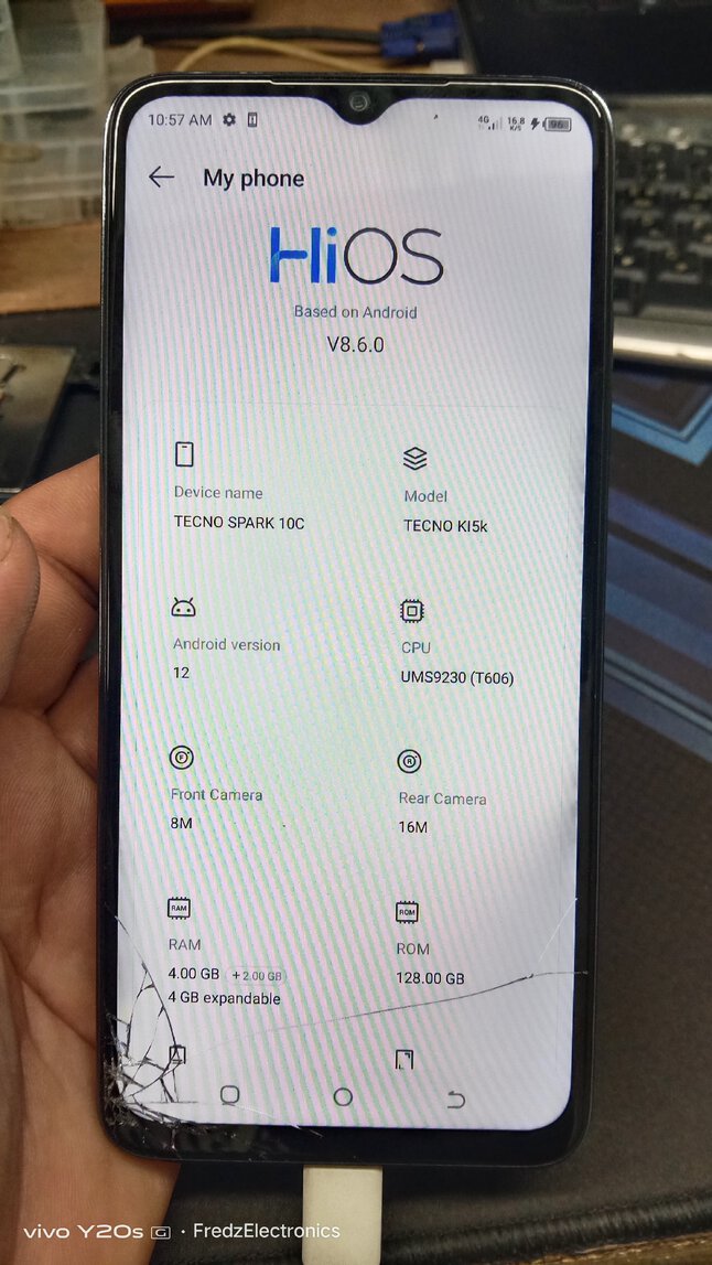

Nakalimutan ang password at may Google Account din.

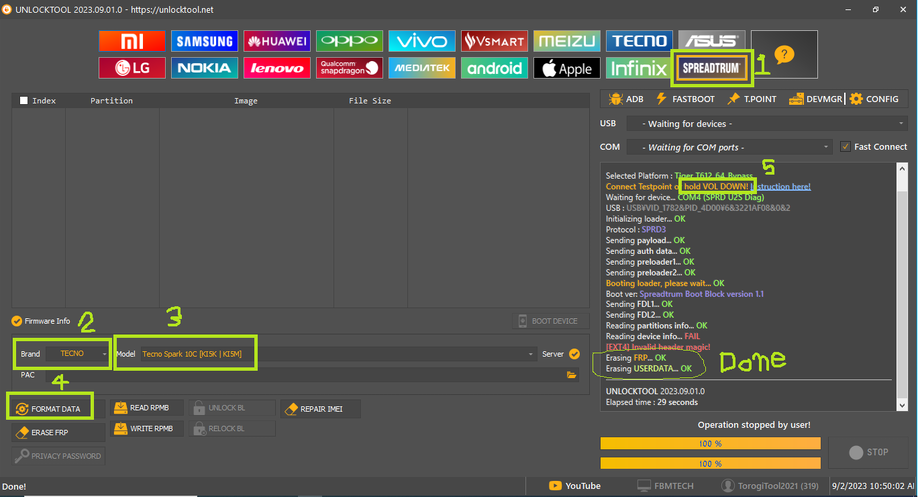

Steps;
1. Open Unlocktool
2. Go to SPD tab
3. Sa brand, Select Tecno then sa Model hanapin si Tecno Spark 10c
4. Click Format Data
5. Hold Volume Down tapos salpak si USB at hintayin mag-detect kay UT bago bitawan. Hintayin lang hanggang matapos.
Password

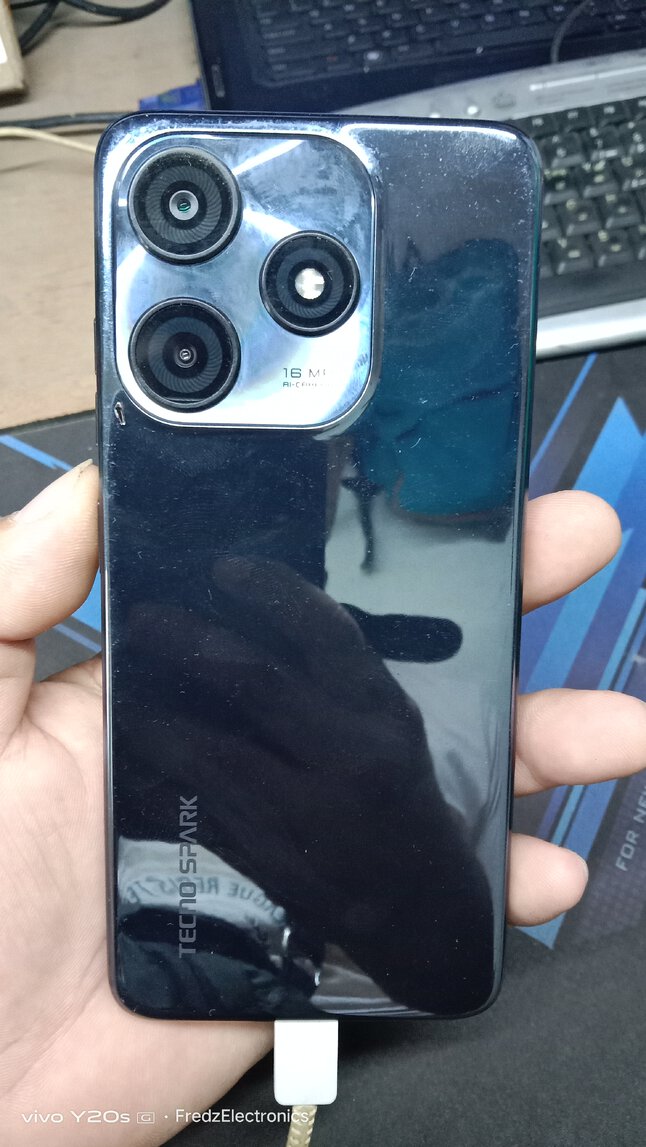

Back cover for reference

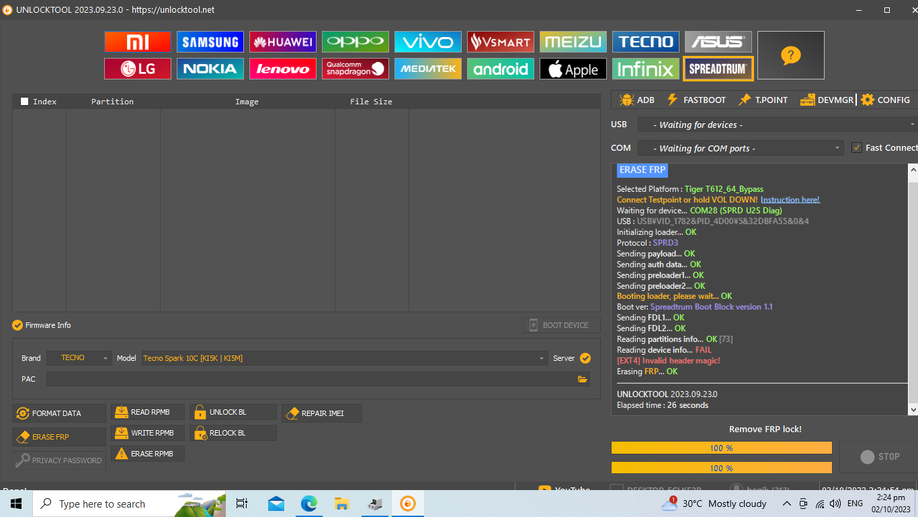

Visual Aid
Info after Done

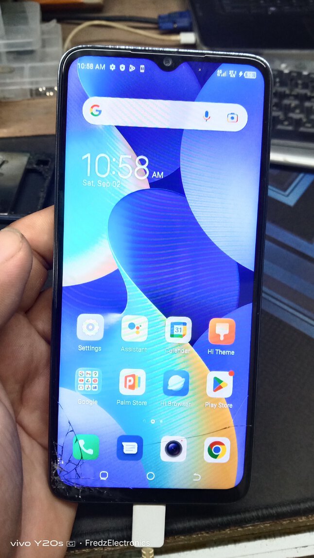

Done
