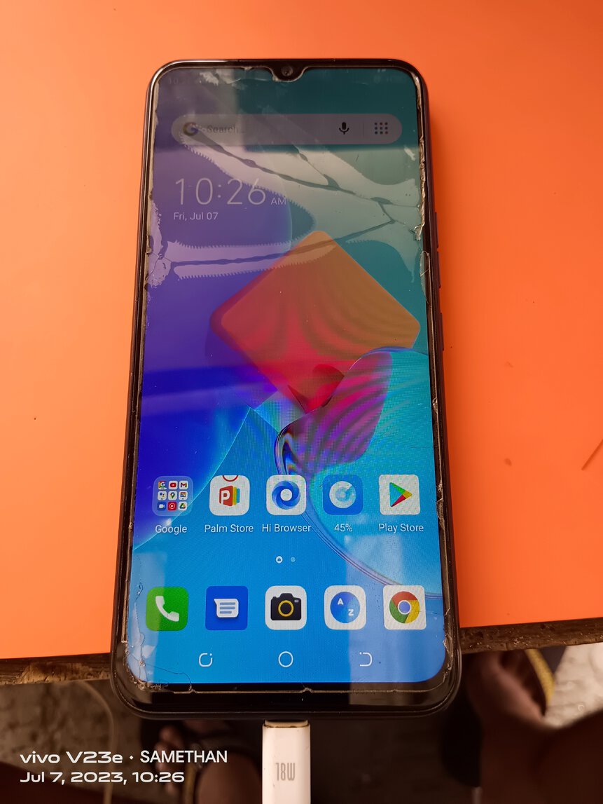

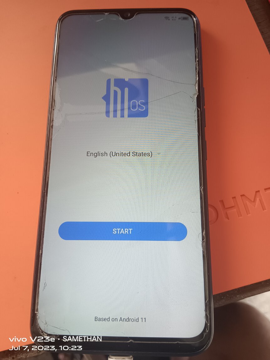

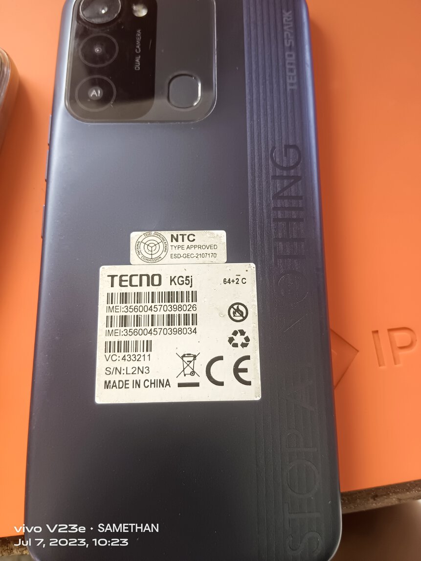

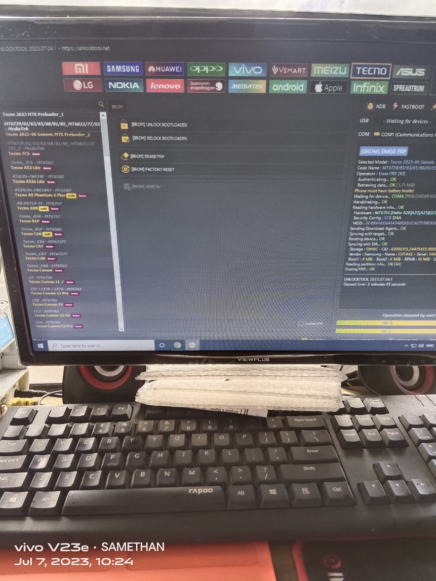

tested po salamat po pre...Action Taken.
1.Open Unlocktool.
2.Open Tecno Tab
3.Select TECNO 2023 MTK Preloader_1
4.OFF ANG UNIT
5.HOLD VOLUME UP/DOWN.
6.HINTAYIN,PERA NAH
Sana makatulong.
maraming salamat po sa pag share,.sirAction Taken.
1.Open Unlocktool.
2.Open Tecno Tab
4.OFF ANG UNIT
6.HINTAYIN,PERA NAH
Sana makatulong.
Thank u boss working 100%Action Taken.
1.Open Unlocktool.
2.Open Tecno Tab
4.OFF ANG UNIT
6.HINTAYIN,PERA NAH
Sana makatulong.
