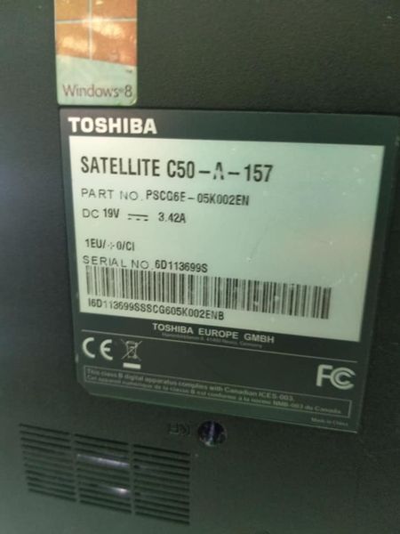

Toshiba satellate C50 no display

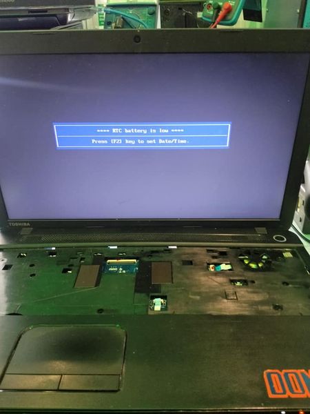

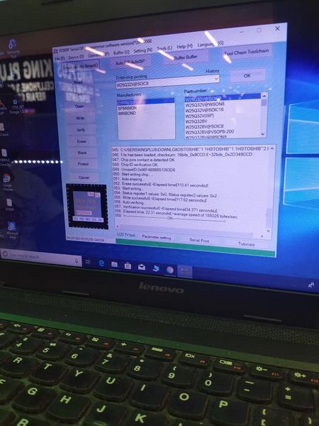

last is flashing bios done...
ito ung ginamit kng binfiles... https://www.antgsm.com/forum/thread...920-sjtnv-it8528e-bios-ec.218079/#post-900555
note: bago mag flash ng bios backup muna ung dati nya for incase di bios ang problema...

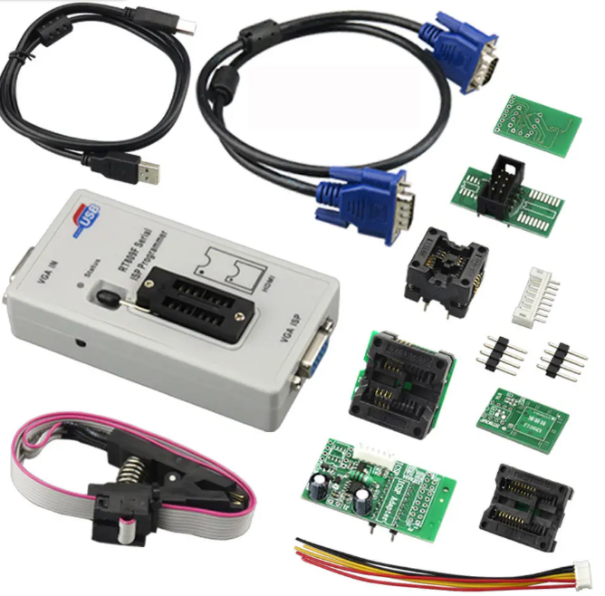

TOOLS
loptop or pc
rt809f programmer
rt809f programmer software download
