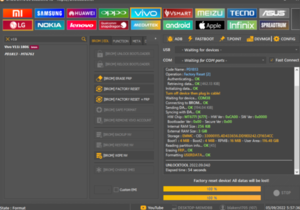

Blakers12 Registered Joined Apr 25, 2021 Messages 25 Reaction score 55 Points 201 Location Pasig Sep 5, 2022 #1 -Open Unlocktool -Select Vivo Tab -Select Model V11i BROM -Hit [BROM] Safe Format Insert USB -Wait Until Finished note ayaw kumagat sa v15 kaya v11i ang ginamit ko

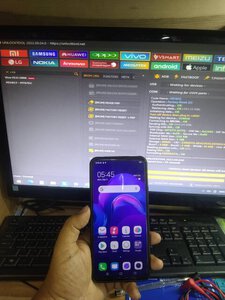

kennethxd Registered Joined Apr 3, 2018 Messages 75 Reaction score 16 Points 201 Location merville pasay city Dec 6, 2022 #2 tested boss salamat Attachments IMG_20221206_175940.jpg 58.4 KB · Views: 3

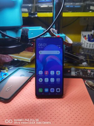

bastie Registered Joined Apr 16, 2021 Messages 44 Reaction score 12 Points 1 Location batangas city Apr 26, 2023 #3 ty lods tested
