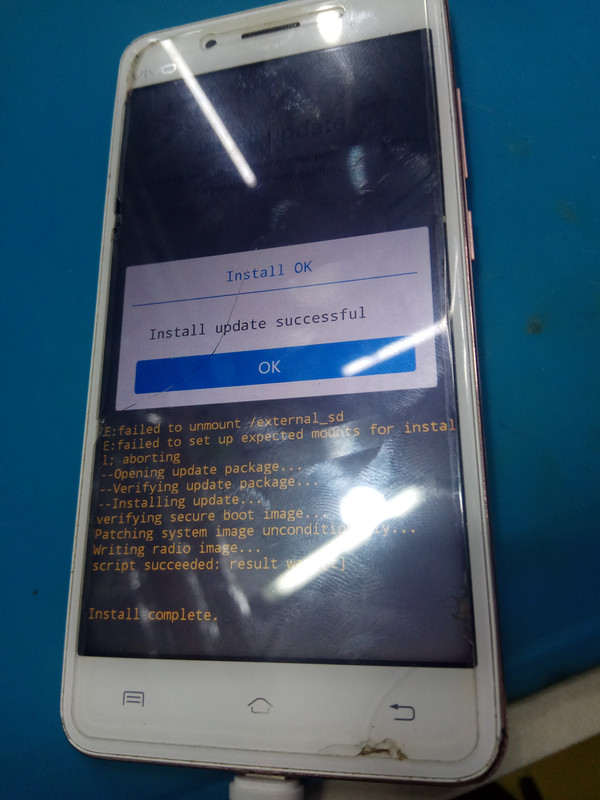

update thru memory card,success pero restart pa din

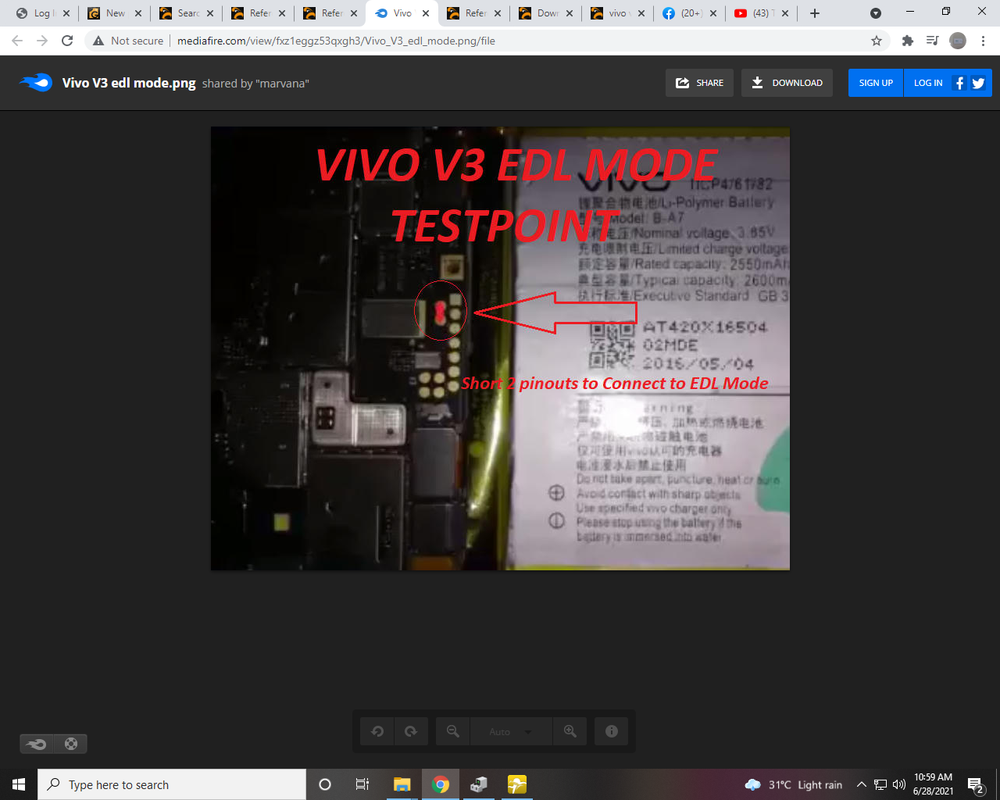

hanap testpoint

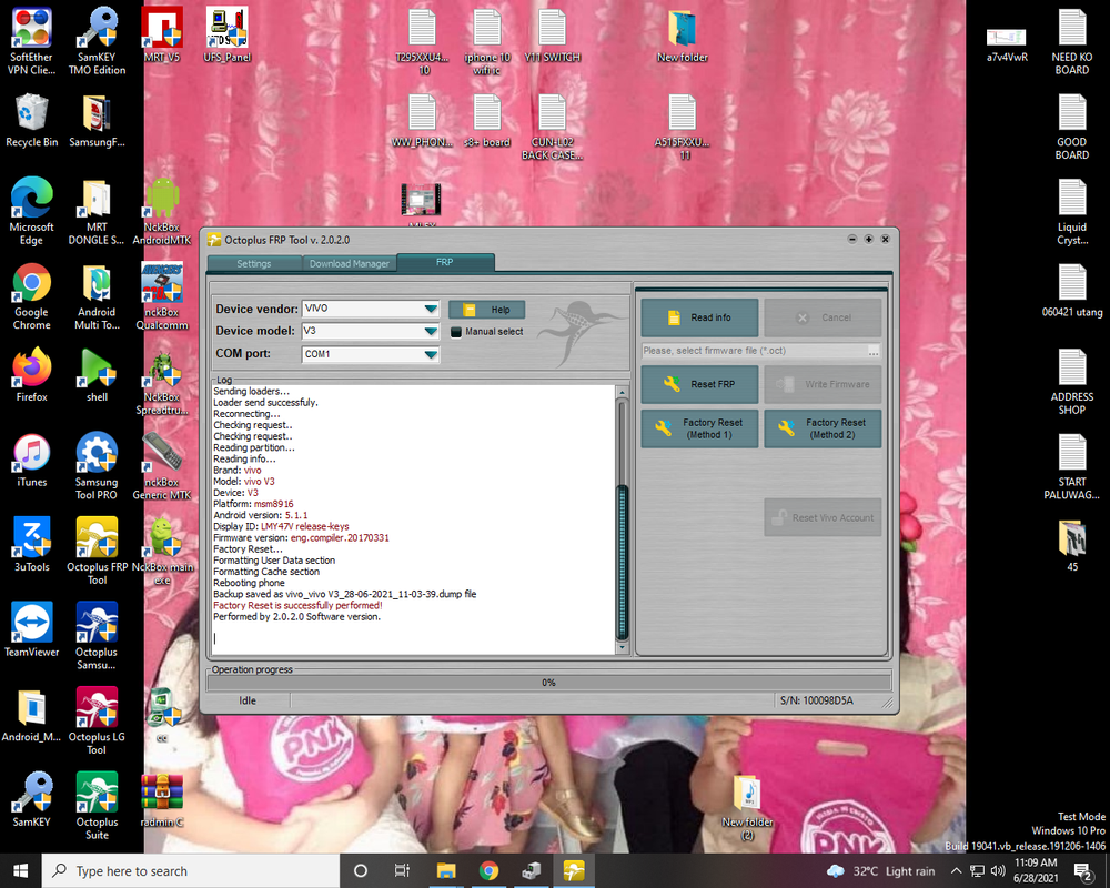

reset thru octopus frp tool done
nadale din
NO BATTERY SHORT TP FACTORY RESET METHOD 1 WAIT OPTIMIZING TESTED

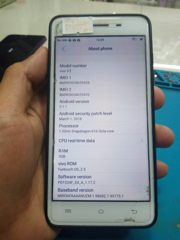

reset uli sa settings try lahat ok na

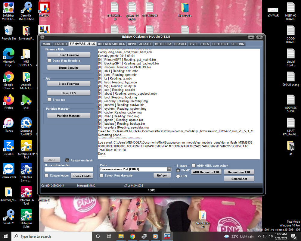

backup thru nckbox qualcom para sa mangangailan
V3 VIVO PD1524F TP LMY47V_vivo_V3_5_1_1NCKBOX QUALCOM BACKUP TESTED

hanap testpoint
nadale din
