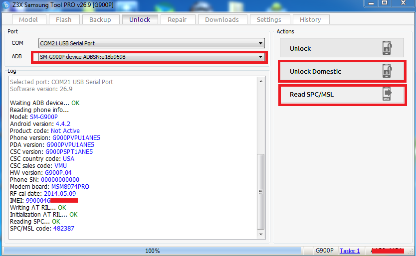

Procedures : just enable USB DEBUGGING connect sa PC
Unlock Domestic sa z3x but no signal,just change signal mode to Global
first enter code ##3282#
Edit
enter MSL read by Z3x (read MSL sa Z3x)
hit ok
More
then HDR/1x Selection
select Global Mode then restart

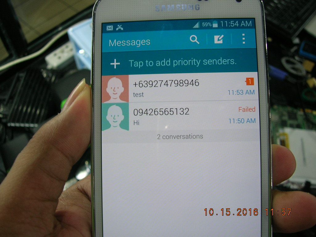

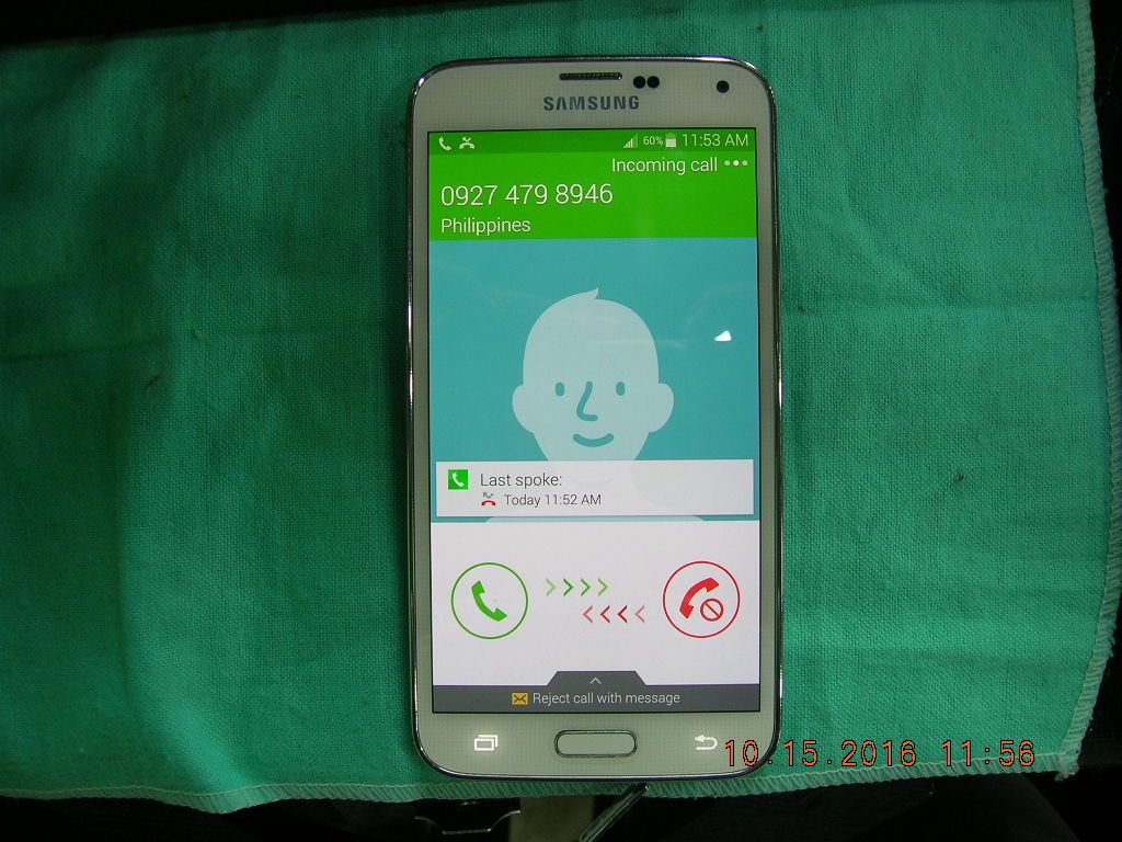

unawain nalang ang pictures
Done Actual Unit :
