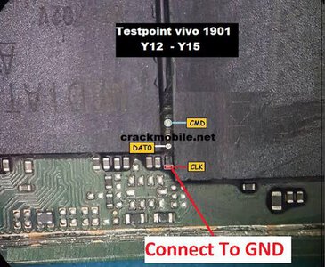

Need Prepare: baklasin nyo na yung unit then Ready na yung TP nya ginawa namin dito nag hinang kame ng wire para hindi mahirapan

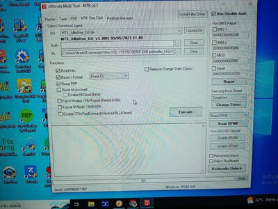

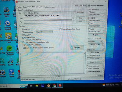

Step 1 : Open UMT yung Old Model nila ng MTK gamit namin dito yung v5.1
Step 2 : Then insert nyo yung file sa PL part
Step 3 : Wag kalimutang icheck yung ✅Reset/ Format at ✅ Reset FRP then
CLICK EXECUTE
Step 4 : TP at Connect na USB cable
Mag done na yan safe yan tested kona...
