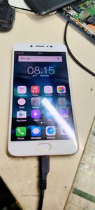

good day dala ni tumer vivo 1601 password try ko unlocktool pero failed.
kaya hanap ako ibang paraan..

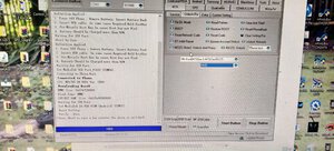

action taken
open miracle crack (thunder edition) ver 2.82
then off ang unit hold+ and -
connect pc
wait lang matapus
at open power a few second
