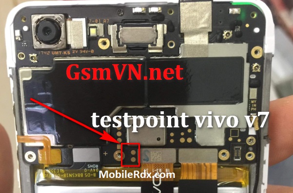

VIVO 1718 V7
UMT
Open QC Fire
Select Brand: VIVO
Select Model: V7
Make Test Point( Remove Batt)
Select Format FS
Execute
then yes to FRP FRP Reset
Wait till Done....

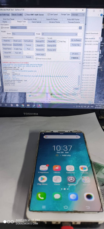

UMT
Open QC Fire
Select Brand: VIVO
Select Model: V7
Select Format FS
Execute
Wait till Done....
