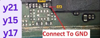

makunat at minsan corupted pa system
kaya eto ginawa ko..
Open UT select Mediatech Universal
check COSTUM PRELOADER EMI
Select model vivo y17 PD1901F
tapos click BOOT DEVICE
iTestpoint ang unit then insert usb
pagnatapos na detect
select FORMART DATA chose RECOVERY
wait hanggang matapos then pwede na
tanggalin ang TP
