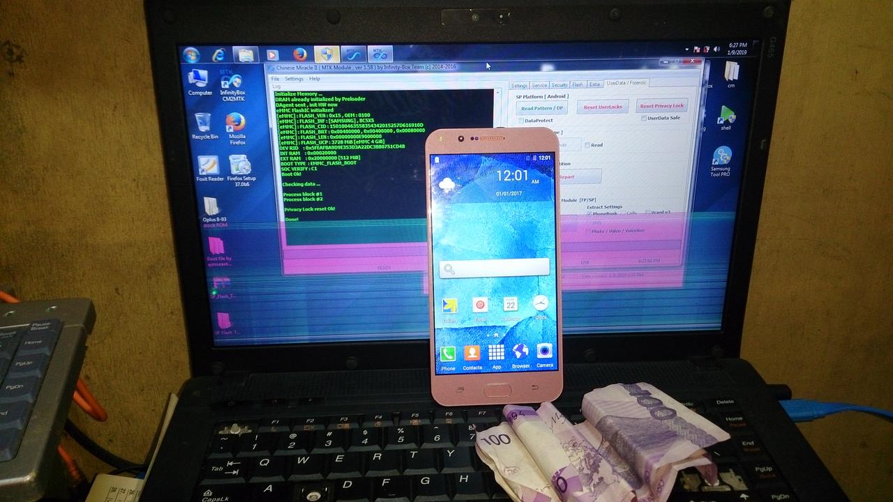

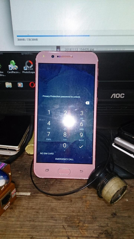

Vivo 5 clone 6580 privacy lock done by CM2
See picture:
Card found : S/N : 27BCCFBB , v0137
Chinese Miracle II [MTK module] v 1.58
Operation : Reset Privacy Lock [ v1.58 ]
Wait for phone...
Phone found! [ 5 ]
Sync...
Inital Boot Ok!
BB_CPU_PID : 6580
BB_CPU_NME : [MediaTek] MT6580_S00
BB_CPU_EXT : 0xCA00 , 0x8A00 , 0x0000
Processing BROM stage
Settings for BROM configured!
SecCfgVal : 0x00000000
BromVer : 0x00FF
BLVersion : 0x0001
Processing DA stage
DA Select done, will use MTK_AllInOne_DA_v5.1624.16.07
Sending and initialize DA ...
Running DA ver.4.2 on BBID : 0x94
NAND Flash : NOT INSTALLED
eMMC Flash : 150100463558354342015257D616910D
Initialize Memory ...
DRAM already initialized by Preloader
DAgent sent , init HW now
eMMC FlashIC initialized
[eMMC] : FLASH_VEN : 0x15 , OEM : 0100
[eMMC] : FLASH_INF : [SAMSUNG] , BC5X5
[eMMC] : FLASH_CID : 150100463558354342015257D616910D
[eMMC] : FLASH_BRT : 0x00400000 , 0x00400000 , 0x00080000
[eMMC] : FLASH_LEN : 0x00000000E9000000
[eMMC] : FLASH_UCP : 3728 MiB [eMMC 4 GiB]
DEV RID : 0x5FEAFBA9D9E353D3A22DC3BB0751CD4B
INT RAM : 0x00020000
EXT RAM : 0x20000000 [512 MiB]
BOOT TYPE : EMMC_FLASH_BOOT
SOC VERIFY : C1
Boot Ok!
Checking data ...
Process block #1
Process block #2
Privacy Lock reset Ok!
Done!
Elapsed: 00:00:24
Reconnect Power/Cable!
Thanks for viewing
