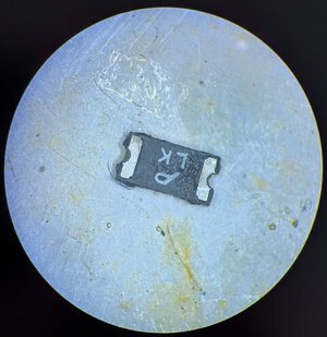

AYAN SA MGA DIPA NAKAKALAAM PWEDE DIN ITO MAGING SOLUTION SA IBANG UNIT
PERO KUNG DI MAG WORK TRY OTHER SOLUTION FLASHING/CHANGING PARTS OR DEPENDE SA UNIT
COMMON ISSUE NA TO NG VIVO OR IBA PANG BRAND KAYA PWEDE NIYO ITONGAWIN SIGURO NAMAN
ALAM NA NG NAKAKARAMI NA "KUTO IS THE KEY" HAHA

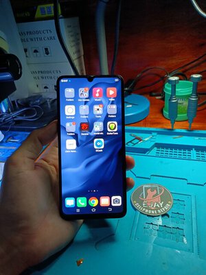

VIVO S1 PRO AUTO RESTART
BAKLAS BATTERY
REMOVE PLK (BATTERY FUSE)
JUMPER USING SOLDERING WIRE
MAS OK TO KESA JUMPING WIRE KASE MAS MAKAPAL MAGAGAWA DITO
DIKO MAUPLOAD IBANG PIC NAKA 48MP PALA ÇAM NA NAGAMIT KO ANTAAA NG FILE
