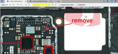

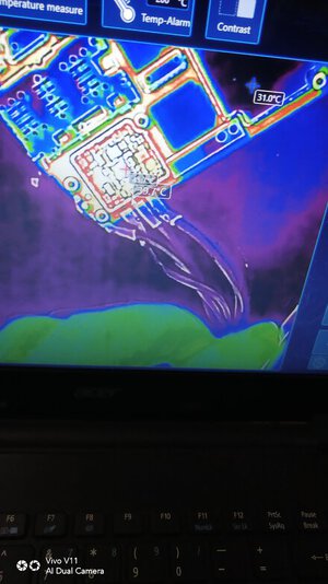

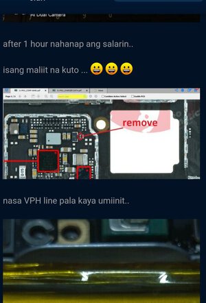

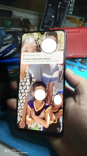

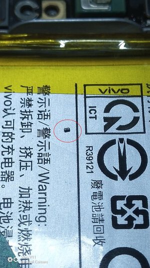

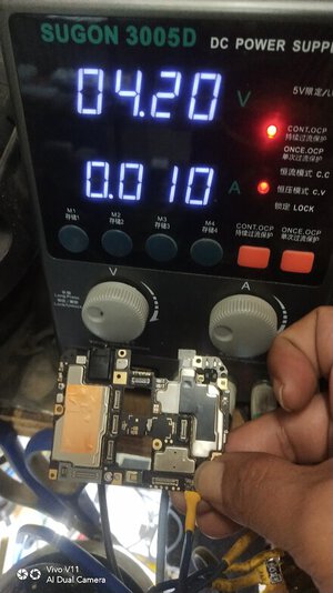

activa2r Administrator Staff member Joined Oct 30, 2022 Messages 714 Reaction score 2,665 Points 241 Location Leganes , Iloilo Feb 13, 2023 #1 Not Booting po ang phone 0.010 leak.. pag naka charge umiiinit ang charging ic.. duling naman si thermal cam di nya mahanap eksaktong fault.. after 1 hour nahanap ang salarin.. isang maliit na kuto ... nasa VPH line pala kaya umiinit.. for reference lamang mga boss... qouta kaagad...

boojooc Moderator Staff member Joined Oct 30, 2022 Messages 212 Reaction score 338 Points 1 Location iloilo Feb 13, 2023 #2 Ty admin sa reference na ito, matanong ko lng removed lng po ba o papalitan po?
activa2r Administrator Staff member Joined Oct 30, 2022 Messages 714 Reaction score 2,665 Points 241 Location Leganes , Iloilo Feb 13, 2023 #3 boojooc said: Ty admin sa reference na ito, matanong ko lng removed lng po ba o papalitan po? Click to expand... remove Mod..
