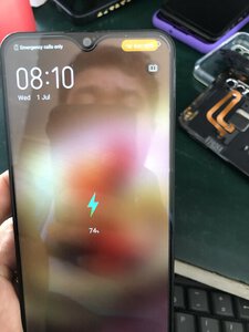

VIVO U3X CN TO GB AFTER FLASHING LUMALABAS (PHONE EXCEPTION) PERMANENT REMOVE KAY UT

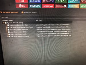

punta ka sa UT
select android tab
click package
search com.vivo.deamonServices

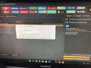

tas right click
tas uninstal com.vivo.deamonServices
wait uninstall ok

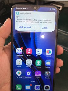

then restart cp
tadddaaaa.
ok na
