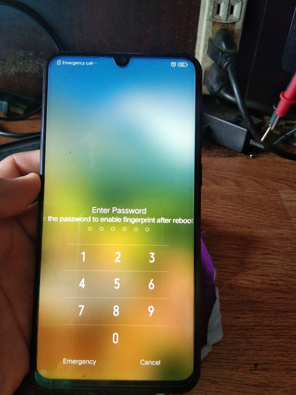

vivo v11i paswword frp done via mrt v.3.19
wala po makitang testpoint, walang advance option para maiREBOOT TO ADB.

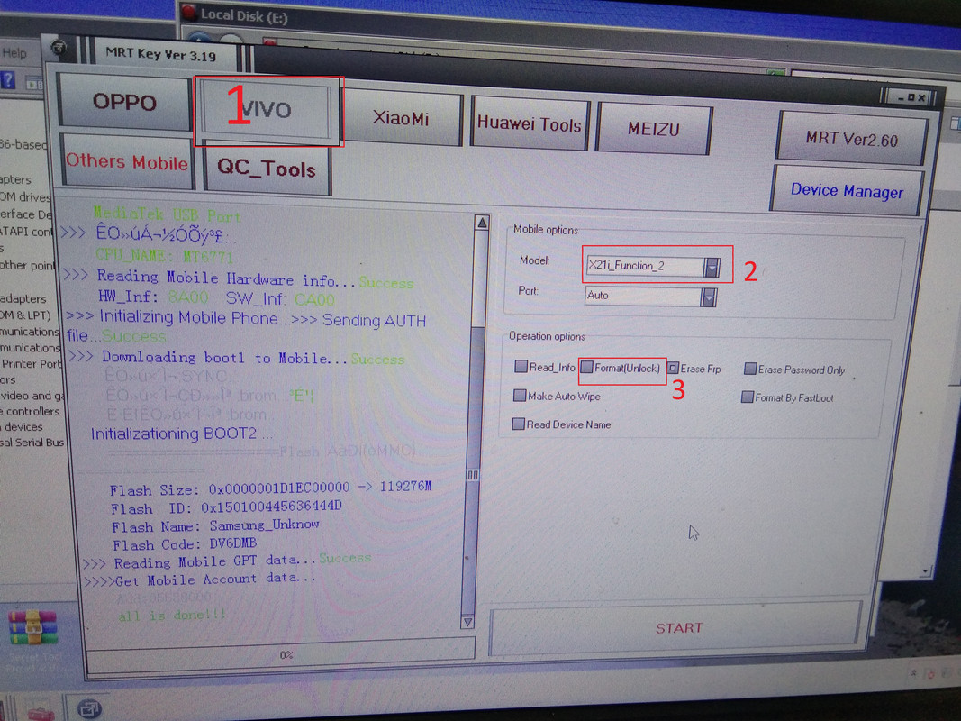

..open mrt v.3.19
..Choose X21i_Function_2
...tick format(unlock)
...tick START

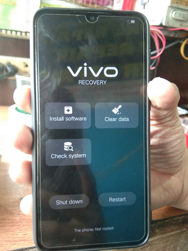

...turn off phone
...press and hold volume up (wag bitiwan, yung aken kase pag binibitawan ko nwawala sa dev manager ,bumubitaw din sa pc)

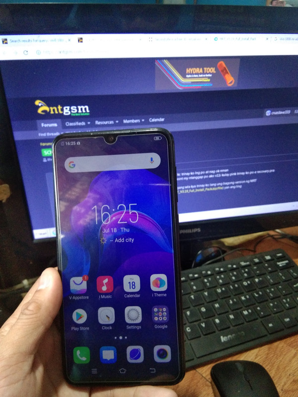

..antayen lang matapos
sa Frp ganun lang din just tick erase frp
sana makatulong
