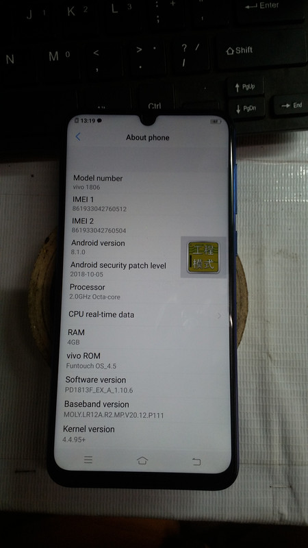

VIVO V11i Password and FRP done via mrt at z3x

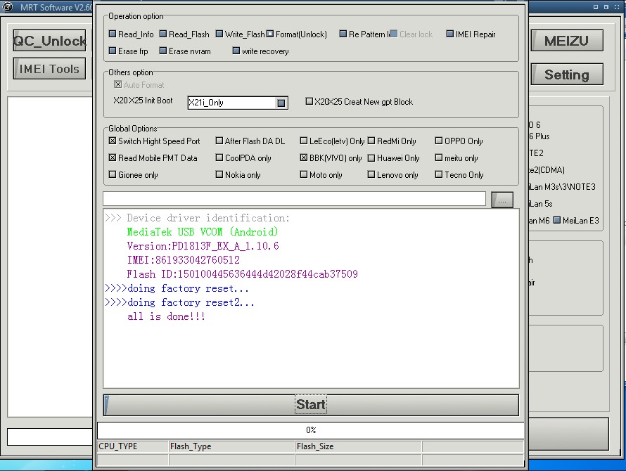

1 press vol+ at power para punta sa recovery mode
choose reboot with adb
2 open ang mrt choose VIVO only
select model X21i only
3 choose format and unlock
4 Tick start and wait

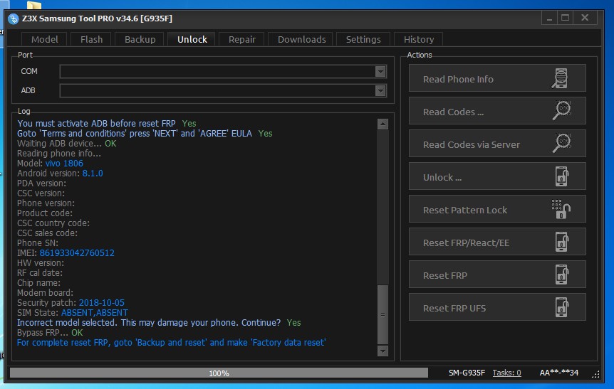

Para matanggal nman ang FRP nia
1 Open Z3X Box
2 select model G935f
3 Ilagay ang phone sa recovery mode
4 select reboot with adb
5 tick reset frp
6 your phone is done and smile
Done..
