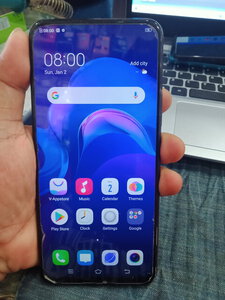

tsunami Registered Joined Jan 5, 2015 Messages 244 Reaction score 42 Points 1 Location Surigao City, Surigao del norte Aug 13, 2022 #1 vivo v15 hang logo swak unlocktool dinala ni tumer naka hang lang bigla lang daw naghang -open unlock tool -click vivo -search vivo v15 -click [BROM/ EDL] -click [BROM] FACTORY RESET + FRP ito na sya after reset kai unlock tool done done done.. kwarta sa lata
