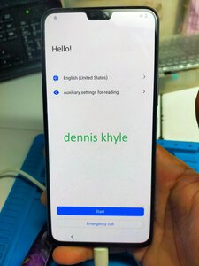

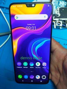

nka frp na ,

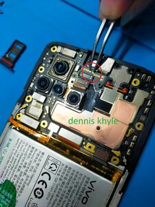

kalas agad si unit para sa test point
yan testpoint,
connet type cord, habang nka test pont ,pag na detect na

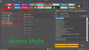

open unlock tool
select ,vivo type v20 ,select vivo v20 pro 5g,brom/edl ,select edl/erase frp.wait mag done
salamat sanay maka tulong
yan testpoint,
open unlock tool
