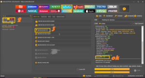

Procedure for password:
*open unlocktool
*click vivo
*select brom/edl
*select V5
*brom factory reset
*hold v+
*insert usb
*wait until done....

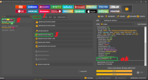

Procedure for frp:
*open unlocktool
*click vivo
*select brm edl
*select V5
*brom earase frp
*hold v+
*insert usb
sana maka tulong sa ating lahat.
*open unlocktool
*click vivo
*select brom/edl
*select V5
*brom factory reset
*hold v+
*insert usb
Procedure for frp:
*open unlocktool
*click vivo
*select brm edl
*select V5
*brom earase frp
*hold v+
*insert usb
