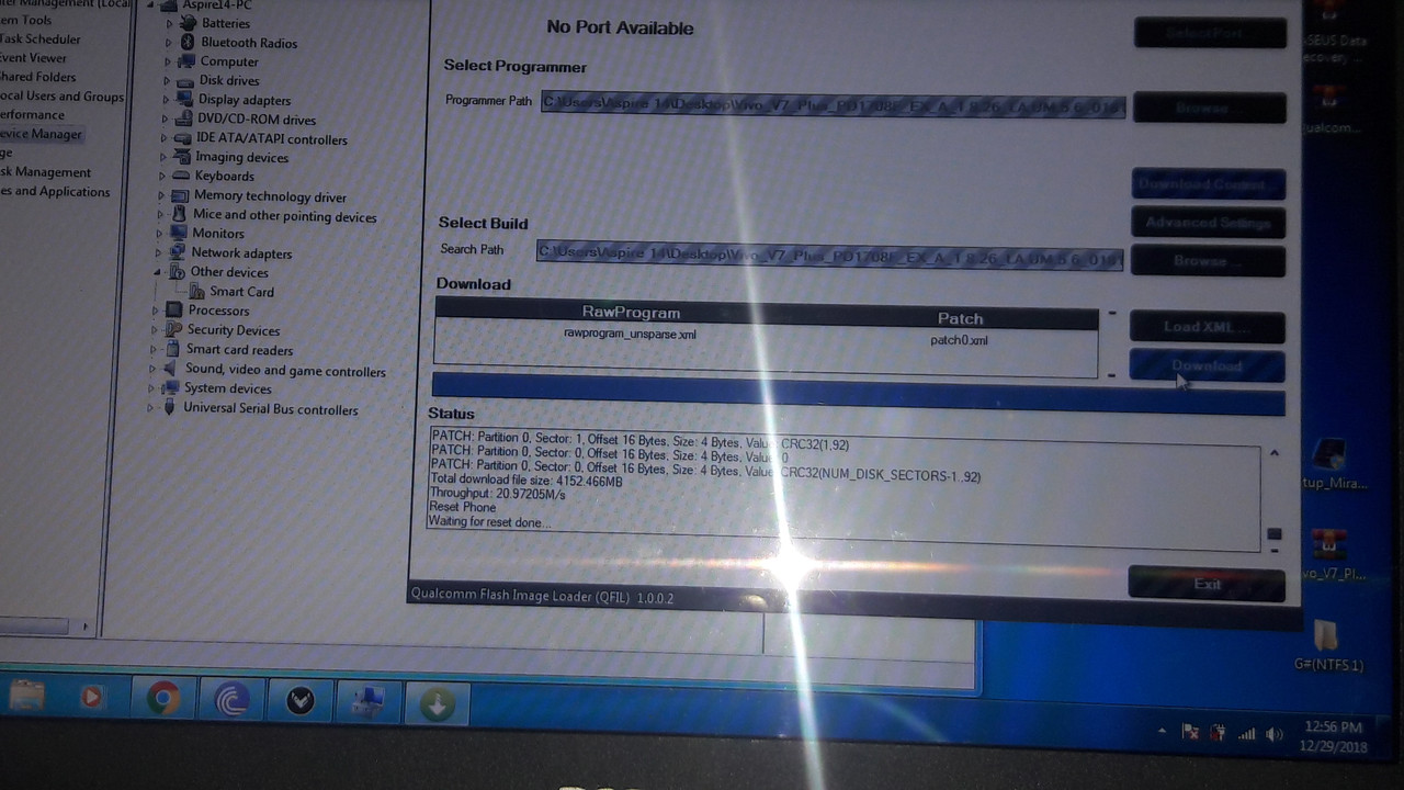

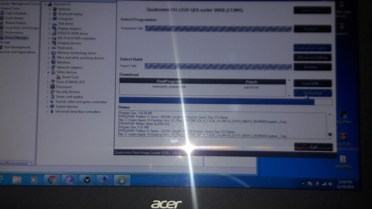

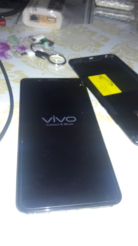

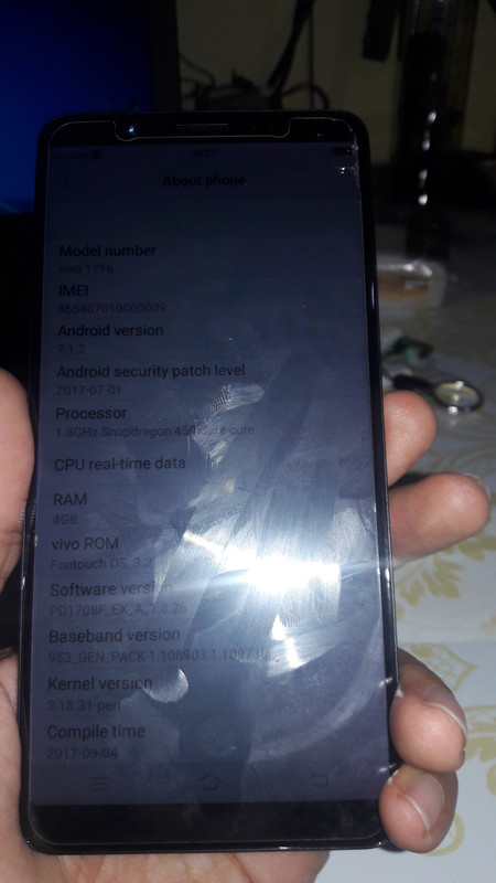

ISSUE: screen lock, frp, nag hang sa logo at blinking lcd na may konting display lower right
side at upper right side lang
ACTION TAKEN :REMOVED SCREEN LOCK AND FRP VIA MIRACLE THUNDER FRP PERO DI
NAG OK SA AKIN EWAN Q BAKA MAY MALI LANG AQ NA MOVES SIGURO
KAYA NAG RESULT SA BLINKING LCD AFTER MAG VIVO LOGO
:TRINY Q DIN SA CM2 QUALCOM Q PERO BIGO PARIN DI MADETECT NG
CM2 QUALCOM Q, PERO SA PC DETECTED NMN ANG DRIVER Q
:TRNY Q DIN MAG CUSTOM FLASH GAMIT MIRACLE THUNDER VIA
QUALCOM USING ONLY SYSTEM GAMIT NUNG BACK UP FILE NG ISA SA
TAHANAN NATIN PERO UN NAMATAY SA KASAMAANG PALAD HEHE
:AND LASTLY NAGHANAP NALANG AQ KAY GOOGLE NG IBANG SOLUTION
AT DINMN NABIGO SALAMT KAY GOOGLE/YOUTUBE
ETO FILE AND TUTORIAL NA GINAMIT Q:
https://mega.nz/#F!D0oFXY6Y
PICTURE PROOFs: PAG PASENXIAHAN NIYO NA NAKALIMUTAN Q TANGGALIN FLASH NG CP Q HEHEHE
