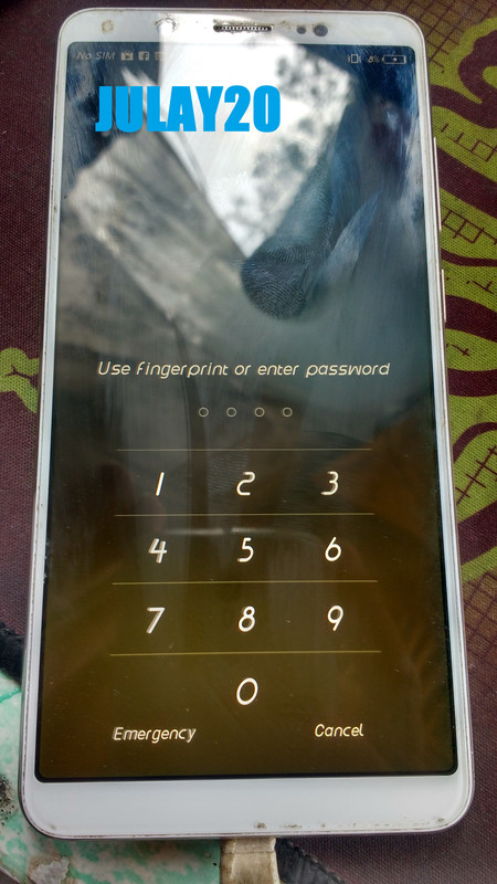

History:
sinanla daw kay mam di na kinoha kaya gagamitin na lang daw ni mam marame pera si mam walang tawad2 hehehehehe....
Password Tool's
Miracle Thunder 2.82 Crack

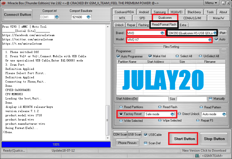

Password Procedure:
oepn Miracle Thunder 2.82 Crack
go to Qualcomm
select Read/Format flash
Click Brand VIVO
Click Model VIVO V7
Click Factory reset Safe mode
Hold voll down and voll up
Click port
Go to Manage silipin kong my driver
pag meron driver
hit start button antayin mo lang mag done
tool picture:

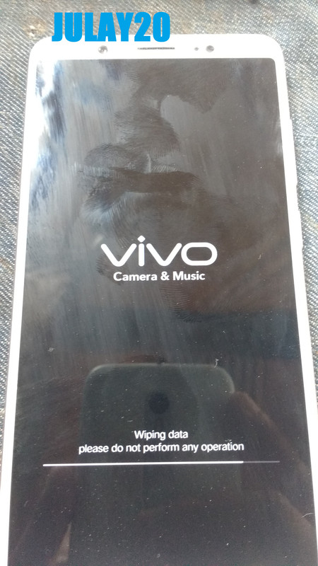

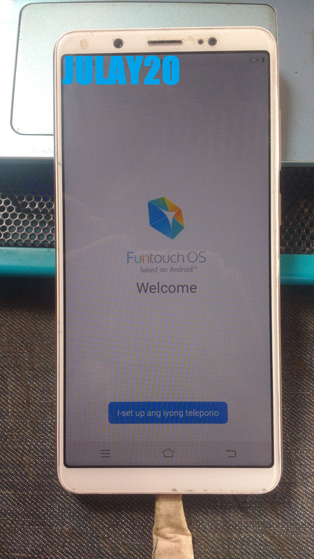

mag on ang unit ganito lalabas
antayin mo lang mag done ito na pag ka tapos
DONE my frp o google account pa pag ka tapos swerte mo kong wala

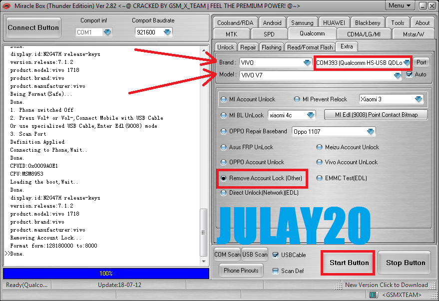

FRP Proedure:
Open Miracle Thunder 2.82 Crack
go to Qualcomm
select Extra
Click Brand VIVO
Click Model VIVO V7
Click remove account lock [other]
Hold voll up and voll down
click port
Hit start button antayin mo lang mag done
tool picture:

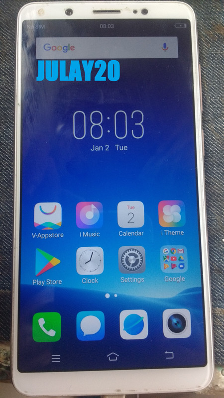

LOG'S
mag on ang unit my lalabas piliin mo yung reboot us power button para mag reboot
next2 mo na sa set up ng phone hangang mag home screen na
ito na sya

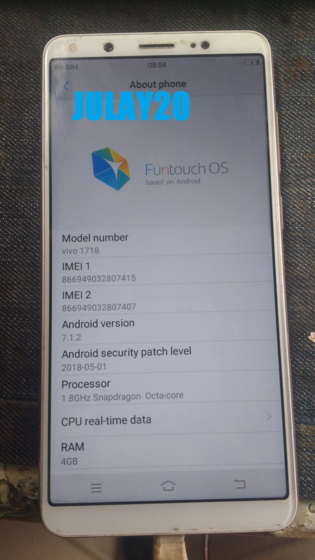

Done for reference lang
note:
wag mona e bigay sa tumer go to settings about phone
tignan mo yung andriod version kong 7.1.2 o 7.0.1
pag ganyan ok bigay mo na sa tomer pero kong 8.0 yan babalik si tumer sa u my na basa kc ako na nag rereboot lang kosa ang unit na yan kaya ang maganda gawin download ka ng firmware downgred mo sa 7.0.1 para safe
iwas sa balik balik ng tumer
sana maka tolong

1. Phone switched Off
2. Press Vol+ or Vol-,Connect Mobile with USB Cable
Or use specialized USB Cable,Enter Edl(9008) mode
3. Scan Port
Definition Applied
Please Select Port First..
Definition Applied
Connecting to Phone,Wait..
Done.
CPUID:0x0009A0E1
CPU:MSM8953
Loading the boot,Wait..
Done.
display.id:N2G47H release-keys
version.release:7.1.2
product.model:vivo 1718
product.brand:vivo
product.manufacturer:vivo
Being Format(Safe)...
>>Done.
3. Scan Port
Definition Applied
Definition Applied
Done.
CPUID:0x0009A0E1
CPU:MSM8953
Done.
product.brand:vivo
Done.
3. Scan Port
Definition Applied
Done.
CPUID:0x0009A0E1
CPU:MSM8953
Done.
product.brand:vivo
Removing Account Lock...
Format form:128180000 to:8000
>>Done.
ito na sya
