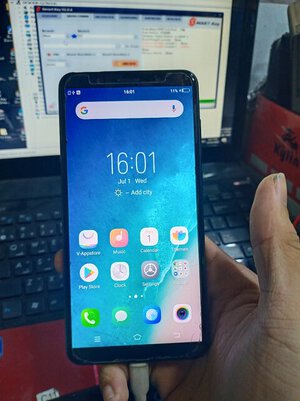

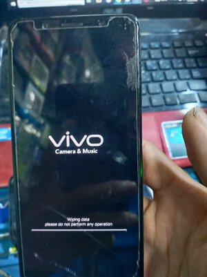

Madz11 Registered Joined Oct 30, 2022 Messages 52 Reaction score 199 Points 201 Location San jose del monte Bulacan Dec 24, 2022 #1 vivo V7 test point baklas unit muna need tp Open Smart key V1.0.2 Click Qualcomm Brand: Vivo Model: V7 Select Reset Userdata 1 tp conect usb cable Then Click Unlock Done Tested po yan sana makatulong mga Boss Master
J j4m2_6 Registered Joined Apr 27, 2021 Messages 1,435 Reaction score 2,967 Points 341 Location La Union ™️ ( Region 1 ) Dec 24, 2022 #2 Tested... tlga yn old but gold
