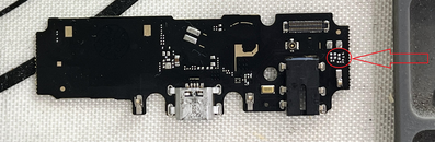

Ultimate Solution: palitan ng original Sub Board
at pag wala
sundan ang simple guide na to
IDEA: ang Thermal rail voltage must be 1.2v +/-
pag umabot sa 2v or more mag Phone temperature too low charging has stopped.
Sub board not original
palitan ng 5k to 15k resistor yung nakabilog Solve ang problema
discovery by _CM_
mas ok ito na solution kesa palitan ng new charging board na try ko temp too low pa din
salamat boss Intoy
at nanatili ko sa forum mo
salamat at my bago na sloution
