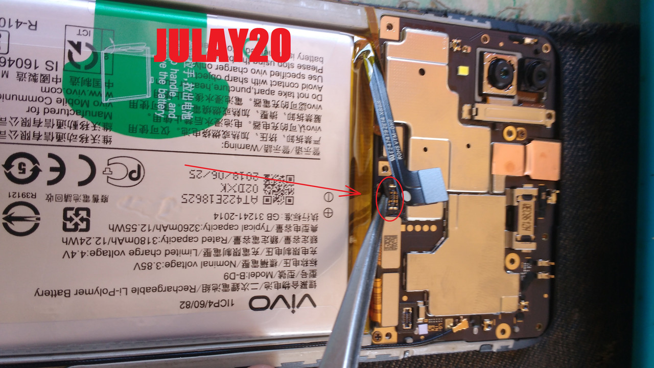

una kaosapin mona ang tumer na kilangan baklasin ang unit kc my tp o testpion na kilangan

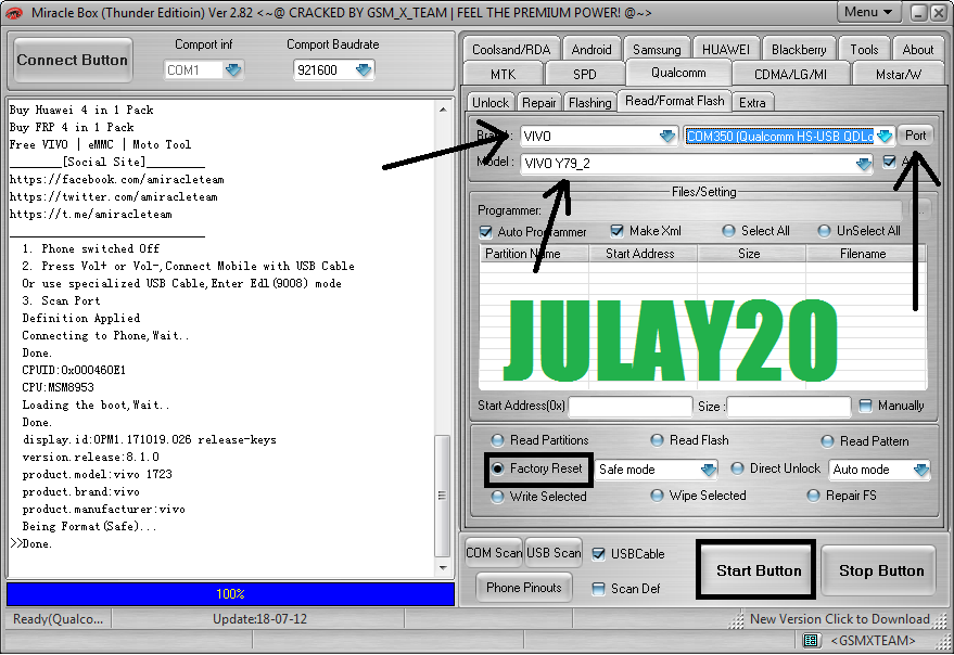

open Miracle Thunder 2.82 Crack
MTK IC go to QLM select brand vivo
click model VIVO Y79_2
select Factory reset safe mode
saksak usb twesser gamit ko pag dikitin mo lang yung testpiont na sa ilalim ng battery
testpiont picture:
click port sa tool pag driver detected na tangalin mo twesser click start button na sa tool wait mo lang ma tapos
TOOL LOG:
done remove password

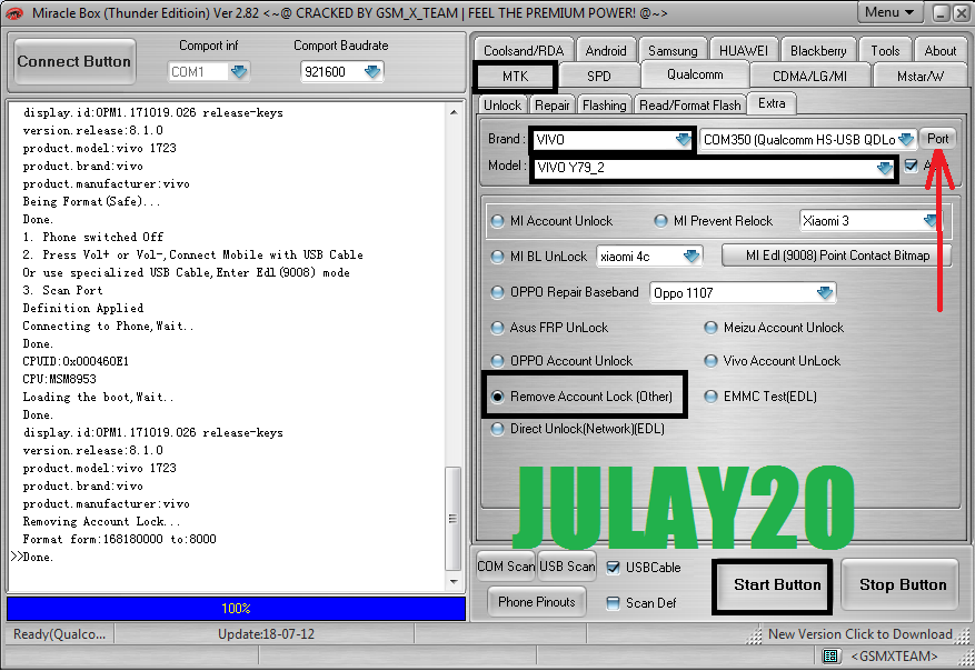

procedure:
open ulit yung crck
QLM click brand VIVO
select VIVO Y79_2
select remove lock other
saksak usb pag dikitin ulit ang testpiont click port pag
click start button
FRP Remove info LOG'S
testpiont picture:
TOOL LOG:

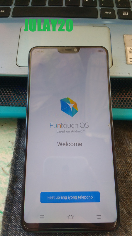

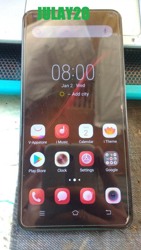

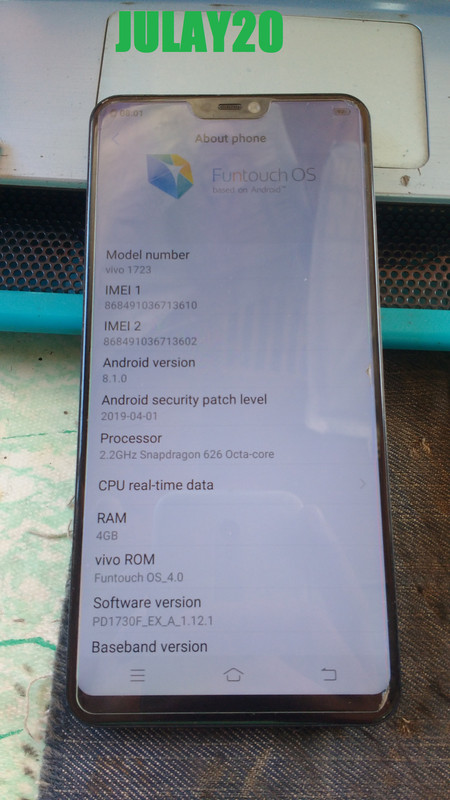

picture:
my frp sya o yung google account
procedure:
open ulit yung crck
select VIVO Y79_2
click start button
