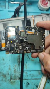

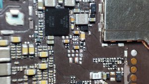

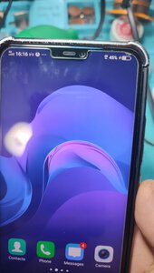

Action taken, try new charging board at charging flex cable negative, try reheat charging i.c nega, try ko nakita kong solution kay pareng gg, ayon connect 6 pods sa pinag tanggalan sa charging ic working na. Take note ang issue nito kahit sa product schematic wala tong ampere na na reread o any charger na gamitin as in walang indicate na nag chacharge.
