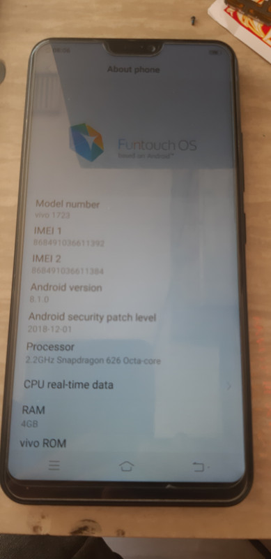

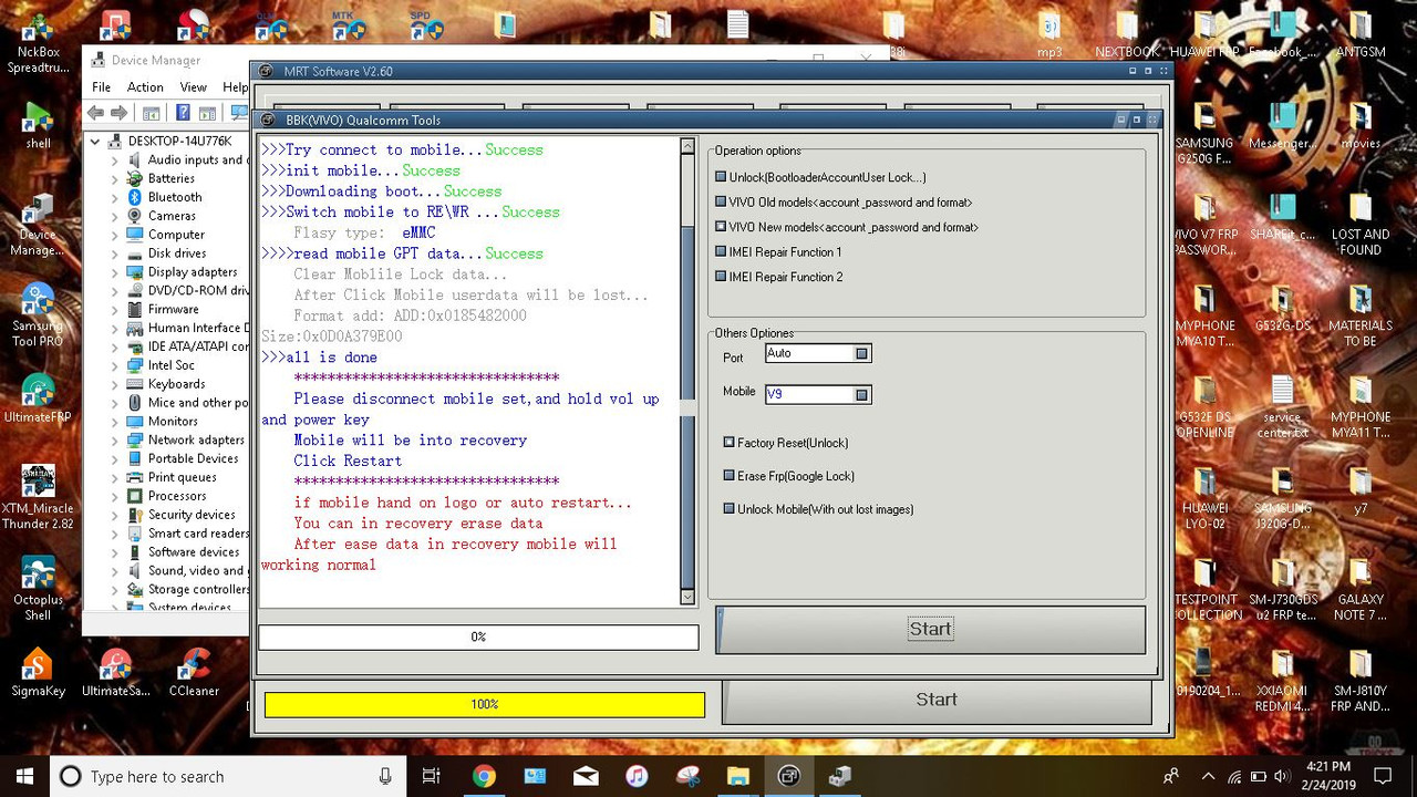

PHONE INFO:
MODEL VIVO 1723
ANDROID VESION: 8.1.0
CPU TYPE: QUALCOM

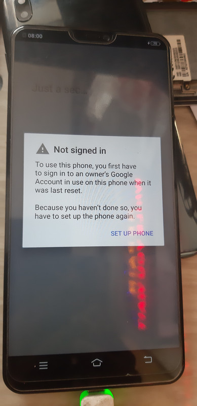

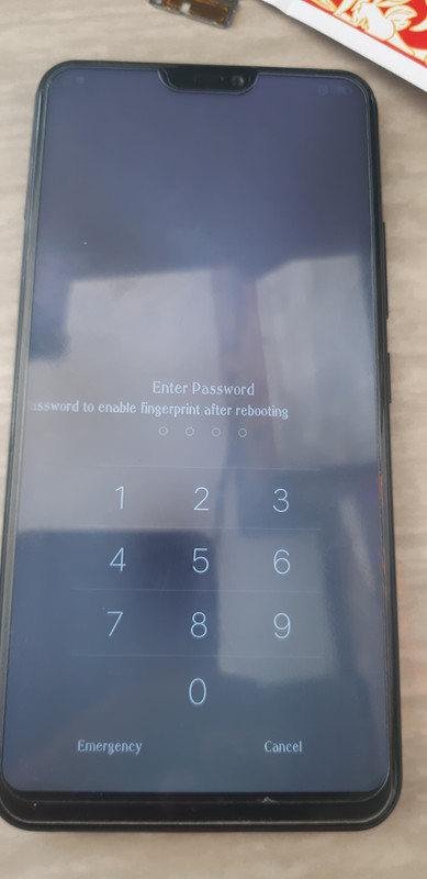

PROBLEM: PASSWORD, FRP
SECOND PROBLEM: PHONE MODEL IS UNKNOWN
AND DETECTED IN DEVICE MANAGER AS MTP DEVICE
INSTEAD OF PHONE EXACT MODEL
SOLUTION:
1. FIND WAYS TO KNOW PHONE MODEL

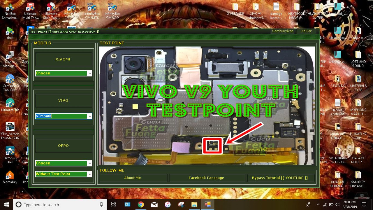

2. PHONE NEEDS TEST POINT FOR PC CONNECTION

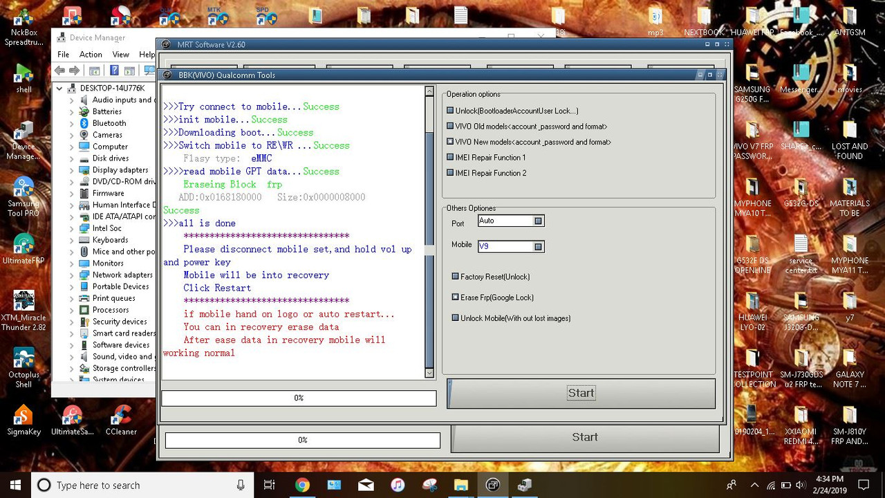

3. USE DONGLE UMT OR MRT TO RESET AND REMOVE FRP
DISASSEMBLE UNIT AND COMPARE MOTHERBOARD SPECIALLY CAMERA
TO GIVEN IMAGES IN TESTPOINT SOFTWARE
THIS IMAGE IS EXACTLY VIVO V9
PROCEED TO:
MODEL VIVO 1723
CPU TYPE: QUALCOM
SOLUTION:
PROCEED TO:
