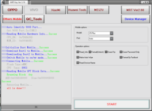

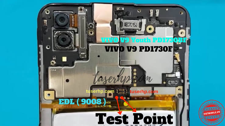

vhanki Registered Joined Mar 16, 2018 Messages 90 Reaction score 13 Points 1 Location legazpi albay Mar 10, 2022 #1 VIVO V9 Password & frp test point muna po natin open mrt crack 3.19 select vivo select model sa V5 PLUS click format for FRP same procedure open mrt crack 3.19 select vivo select model sa V5 PLUS click FRP sensya na kung walang ss yung cp ni tumer nagmamadali...
BongKier Registered Joined Jun 15, 2021 Messages 361 Reaction score 246 Points 41 Location NAGPAYONG 2, PINAGBUHATAN PASIG CITY Oct 6, 2022 #2 tested salamat master
