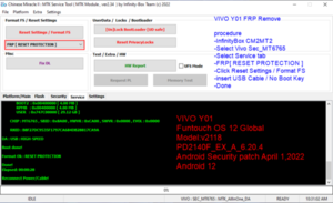

VIVO Y01 FRP Remove v2118 PD2140F new patch Android 12
1st: hydra no lock
2nd: InfinityBox done
procedure

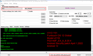

-InfinityBox CM2MT2
-Select Vivo Sec_MT6765
-Select Service tab
-FRP[ RESET PROTECTION ]
-Click Reset Settings / Format FS
-insert USB Cable / No Boot Key

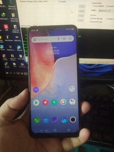

-DONE
Finish Product
