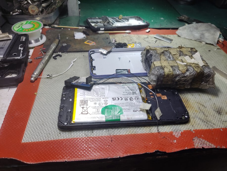

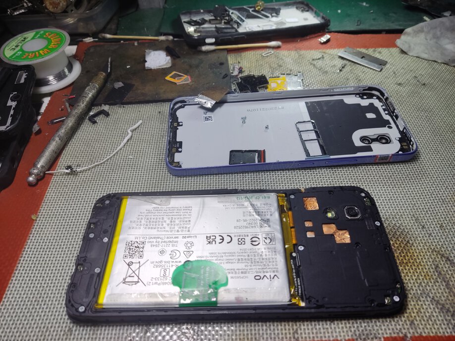

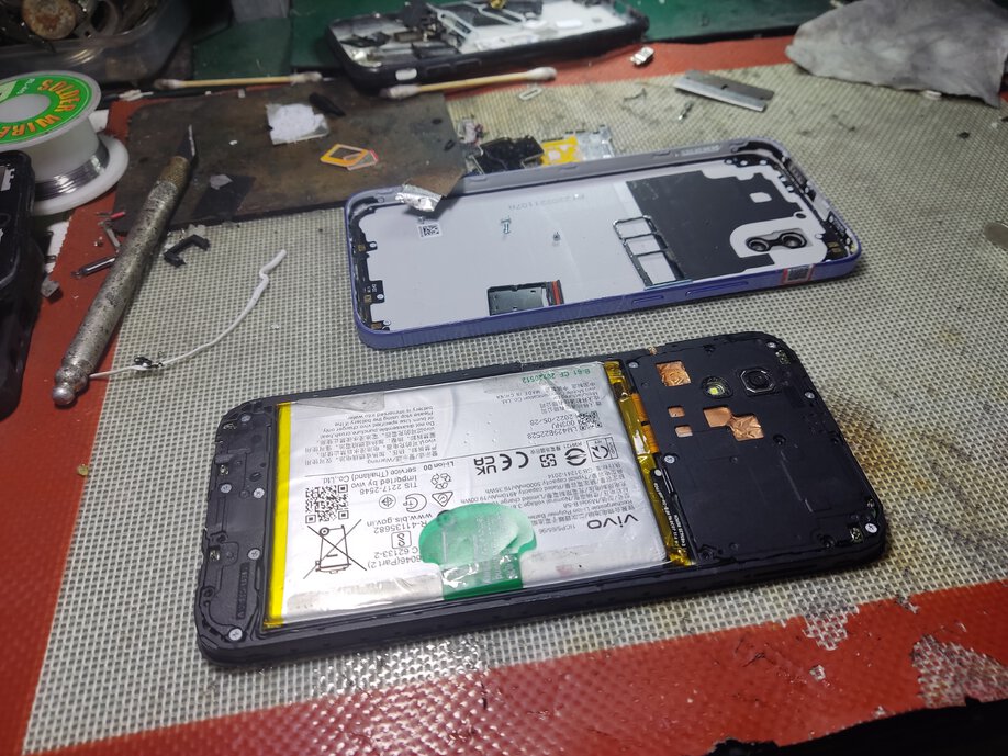

GANDANG AFTERNOON SA LAHAT.
TANGGAP KO VIVO Y02 ABOGBOG ABERNA BASA LCD BIKONG FRAME NAKA PASSWORD
UNA PALIT LCD SUCCES NA
PANGALAWA HARD RESET SUCCESS DIN

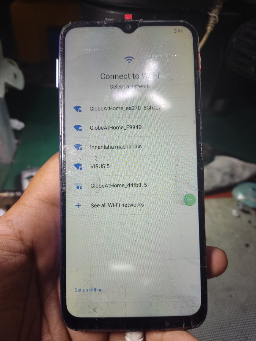

PERO PANGATLO SA FRP ANGKUNAT LAHAT NG DAAN DINAANAN NAMIN TATLONG TECH NA SUMUBOK PERO SA KAMAANG PALAAD HINDI MATANGGALAN FRP...

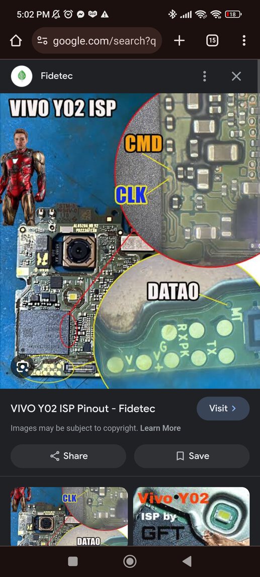

NOW NAG RESEARCH AKO IF MERON IBANG WAYS, NASILIP KO SI GOLOGOLO MERON SIYA ISP PINOUT VIA EASY JTAG SO DALI AKO KUHAIN PINAKATATAGOKONG JTAG NILAGAY KO MGA PINOUT NI SOCKET AT AYUN NGA NAG READ SA EMMC MANAGER, ACTION TAKEN PINDOT KO C REMOVE GOOGLE ACCOUNT FRP.
NOTE: EMMC MANAGER GINAMIT KO MGA VOSS. AYUN SAPOL SUMINGAW DIN AT NABUTASAN KO ANG MAKULIT NA MAKUNAT. DAGDAG NANAMAN ITO NG KAALAMAN, NAG TAKE RESK AKO
