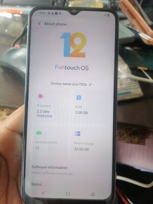

vivo y02s frp;
knapa sa kamay walang skip,walang nangyari ,
kaya hahanap ng paraan. ang pinoytech,
cm2---- alaw X
mrt ---- alaw X
alaw din akong U.T ... hehehe walang budget
ito one click lang
1. power off phone
2. press Volume up and down
3. click start sa

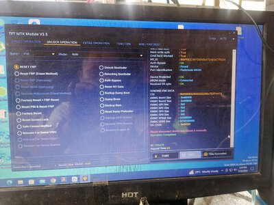

TFT mtk module v3.5 dl...
https://www.4shared.com/rar/gebHddvTfa/TFT_ToolDrivers_SAHIL_TECH.html?
https://www.mediafire.com/file/5y3fkwfsmj7ohe9/TFT+Tool+Drivers+SAHIL+TECH.rar/file
TFT MTK Module -- v3.5
Current version : 3.5
User : DESKTOP-9HU6DH7
License : Activated
LocalTime : 2/16/2023 2:13:57 PM
OS : Microsoft Windows 10 Pro
OS System : 64 Bit
TFT is Supported with Windows:

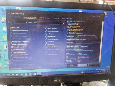

============== Operation Info ==============
Preparing Path ..........OK
Reading data ..........OK
Operation {Factory Reset + FRP Reset}
Brand : Auto
Model : Auto
How To Boot : Power off phone
* BROM Mode : Press VOL + or Press VOL -+
* Preloader Mode : Just Insert cable
Waiting For Device Connection.....
Device : Found
Port Identification : Flashmode BROM
CPU : MT6765(Helio P35/G35)
Disabling Watchdog... : OK
HW CODE : 0x766
SBC enabled : True
SLA enabled : False
DAA enabled : True
SWJTAG enabled : True
Mem read auth : True
Mem write auth : True
Cmd 0xC8 blocked : True
ME_ID : B86FF8CC7617D0095EA7EAB04C7F9296
Auth Bypass : OK
Device : Found
Device Protected : OK
BROM mode : Connected
Received DA sync : OK
SENDING EMI DATA
CID : 9b010059325030333200bc752f74197d
EMMC Boot1 Size : 0x400000
EMMC Boot2 Size : 0x400000
EMMC GP1 Size : 0x0
EMMC GP2 Size : 0x0
EMMC GP3 Size : 0x0
EMMC GP4 Size : 0x0
EMMC RPMB Size : 0x1000000
EMMC USER Size : 0x747c00000
DA-CODE : 0x666D0

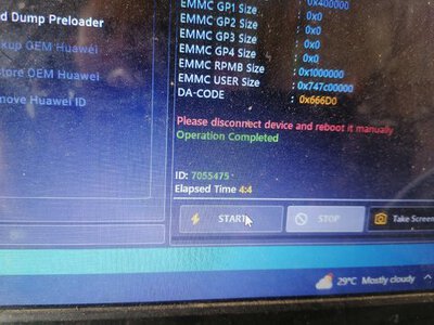

Please disconnect device and reboot it manually
Operation Completed
Elapsed Time 4:4

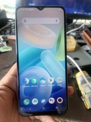

Thank you sa akin ay okey nah!!!!
