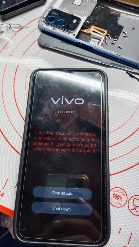

VIVO Y11 1906 PASSWARD
FORMAT BY UNLOCK TOOLS
NEED BAKLAS MGA IDOL
PARA MATEST POINT NATIN
PROCEDURE

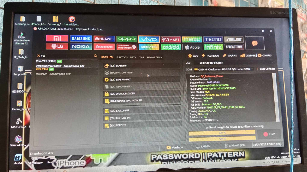

OPIN UNLOCK TOOLS
STEP 1 CLICK TAB VIVO
STEP 2 HANAPIN MO VIVO Y11 1906
STEP 3 READY MO UNIT
STEP 4 REMOVE BATTERY CONECTOR
STEP 5 TEST POINT MO
STEP 5 CLICK MO EDL FORMAT RESET
STEP 6 CONICT USB CABLE

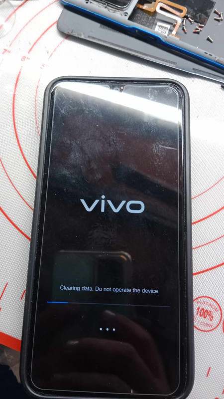

STEP 7 WAITING MO HANGANG MATAPOS
DONE FINISH
