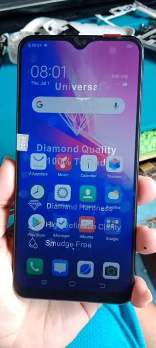

PROCEDURE
VIVO Y11 1906
PASSWARD PROBLIM

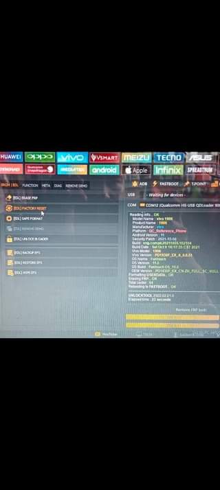

BAKLAS UNIT TP
OPIN UNLOCK TOOLS
SELECT TAB VIVO
TYPE SA SEACH Y11 1906

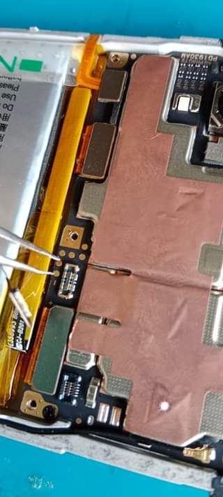

TEST POINT CONECT USB
CABLE CLECK

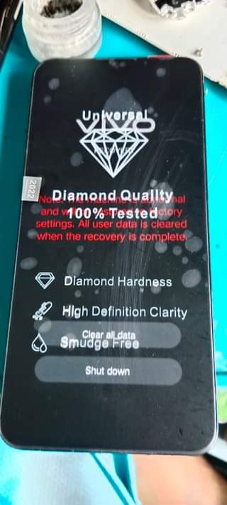

(EDL FACTORY RESET
WAITING DONE MO
FINISH DONE
