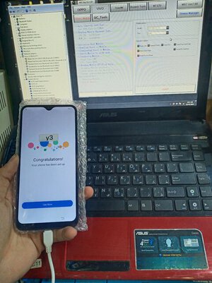

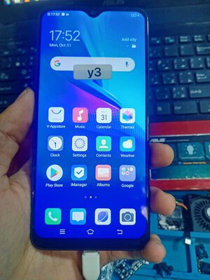

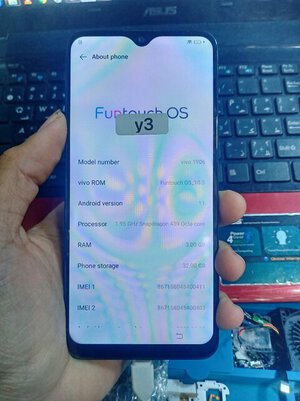

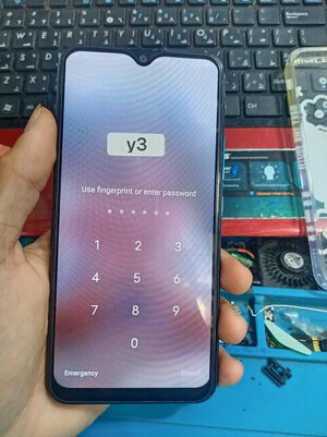

Vivo (1906) password & frp done

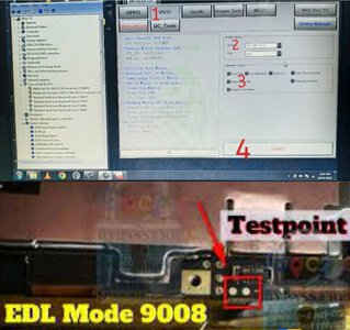

Testpoint
Open MRT CRACK V3.19
Click ViVO
model: Y93 Y95 V11 U1
auto
select FORMAT (unlock)
click START
Now Connect Usb Cable & Remove the Battery tusokin mo nanjn sa baba yung picture.
picture.
